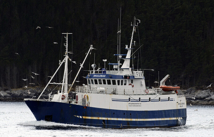

With Hydrogen fuel cells on board, MS Skulebas will be the world`s first zero-emission fishing vessel. Picture: Hvide Sande Shipyard*
MS Skulebas is used for training of future fishermen and fishery research, both for finding, catching, handling and processing of different types of fish:
She replaced a 42 year old vessel by the same name and purpose:

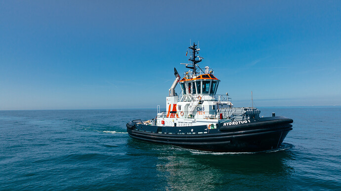

Will this make a difference for green hydrogen use on ships?:
So 400 kW is not enough to power large ships, but multiple fuel cells, just like banks of batteries, to meet the requirement may be feasible. (??)
I dunno about feasible, it could replace generators on big ships but you’d need around 50-200 of those for a large ships propulsion. They’d probably be better off scaling it up bigger, dunno how well that could be done.
Fuel cell can be “stacked” just like battery backs (or stacks) according to TECO 2030:
I haven’t seen any measurements for the “FCM400”. (??)
Does that mean that the “FCM400 marine and heavy-duty hydrogen fuel cell module” is small enough to be “stacked” into a power bank(s) with sufficient output to power ship’s propulsion, w/o taking up too much space?
It looks pretty reasonably sized by the image in the article. Still dunno how feasible to pipe in 200 of them, maybe 50 though… I’d opt for a scaled up version, probably cheaper that way
Don’t know if that gray box is the FCM400 fuel cell, or if that is something used in the testing.
If it is ONE fuel cell I agree , it would be difficult to stack 200 of them together.
But not many ships need 400 kW = 536 Hp x 200 = 107282 Hp.
50 X FCM400 = 26820 Hp sounds like a more common propulsion requirement.
PS> Fuel cells still require less space than a diesel engine of similar capacity. (I think)
