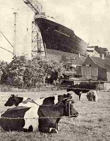

The ms Amstelkroon was built in an idyllic environment.
