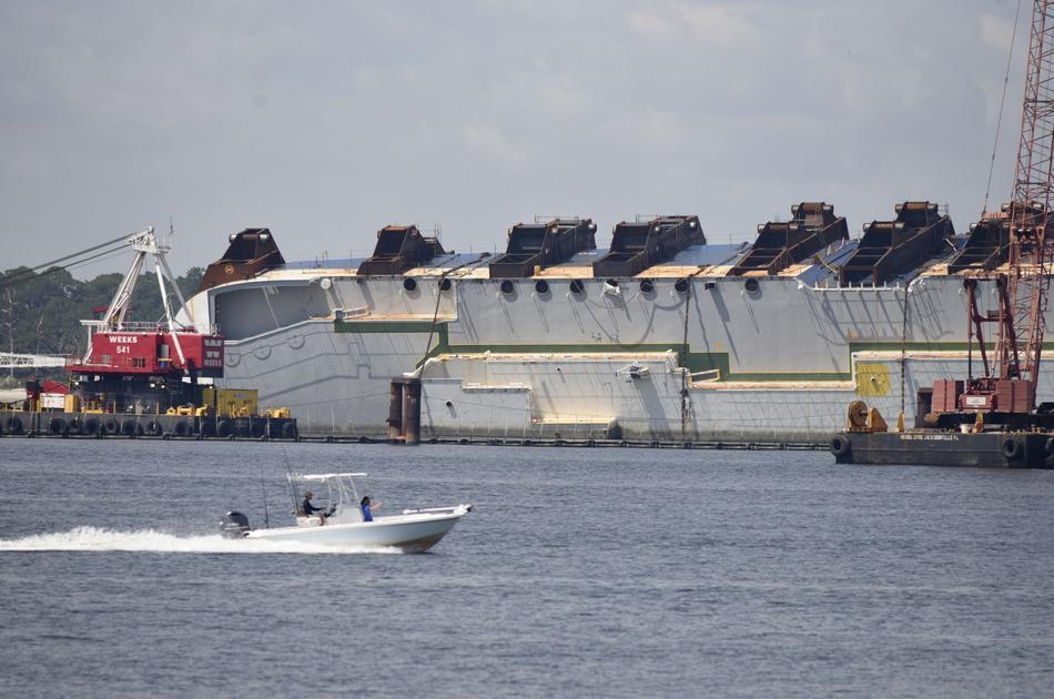

Short 1500 tons of ballast.
Stability issues is a polite understatement. Capital mistake with a lot of consequences.
I’ve not found much from a couple quick searches. I did read the C/M’s testimony. The calculated GM was around 2.5 meters. I’d guess the minimum required GM would be around 1 meter. Evidently both the cargo and ballast weights were incorrect.
Sounds very similar to the MV Höegh Osaka incident in Southampton. The C/M of the Golden Ray testified that he didn’t have a final stow plan but was using estimated weights
Golden_Ray
Standard practice in load ports for used cars. In ports where new cars are loaded almost always get a good pre-stow with exact weights.
