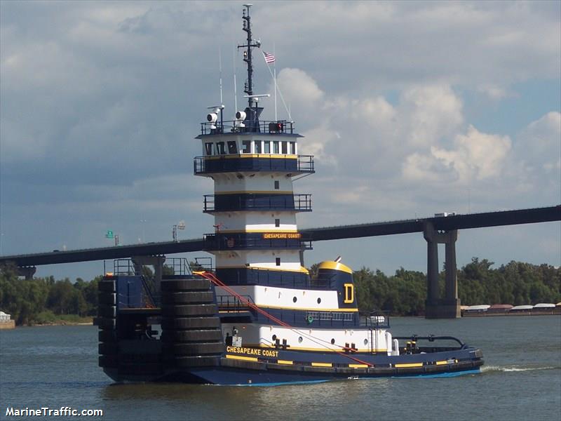

Found a picture of an American push tug of “modern”(??) design an thought it may fit into this category.
To me this is butt ugly and scary:
I assume there is an elevator to get up to the bridge, but I still wouldn’t want to be on this one, especially “out of the notch” in bad weather.
Anybody with experience from similar tugs who would like to elaborate?
That boat isn’t designed to go outside protected waters and it is never in a “notch” in the first place.
Looking at those push knees being heavily fendered on the side, I looked it up:
http://www.professionalmariner.com/American-Tugboat-Review-2011/Chesapeake-Coast/
Looks like they intend to work both inshore and offshore in rough weather and be able to push in the notch, but without being “rigidly” connected.
It appears I’m wrong.
I doubt they intend to work in rough weather but if they get caught it in it out shouldn’t be too terrible.
The push knees on the bow pretty clearly signify it’s NOT going to push in a notch.
No I agree that they probably don’t intend to operate in really bad weather offshore, but they are prepared to take the barge in tow if they do:
Besides, they appear to have a different way of thinking from the majority of the US tug and OSV owners.:
I would hope they plan to try to not be out in bad weather. Looking at that bow I can’t imagine it would take seas very well.
I’m not all that familiar with American push tugs, especially the inshore type, but I have seen some of them, both afloat and on dry land, and I respectfully have to say that none of them look like they should have been allowed into open waters.
The argument about this one is that the bow configuration is much more suited for rough seas:
They very rarely leave the Delaware river or Chesapeake bay. Occasionally run up the coast to New York or out Long Island sound in nice weather. Sometimes even on Chesapeake bay you need to tow because the differences in movement between the tug and the barge will break your push gear.
They frequently are limited in their max speed when they aren’t pushing because their flat bow ships water.
I realize that, but it’s still somewhat flat above the waterline and would still not ride seas very well.
