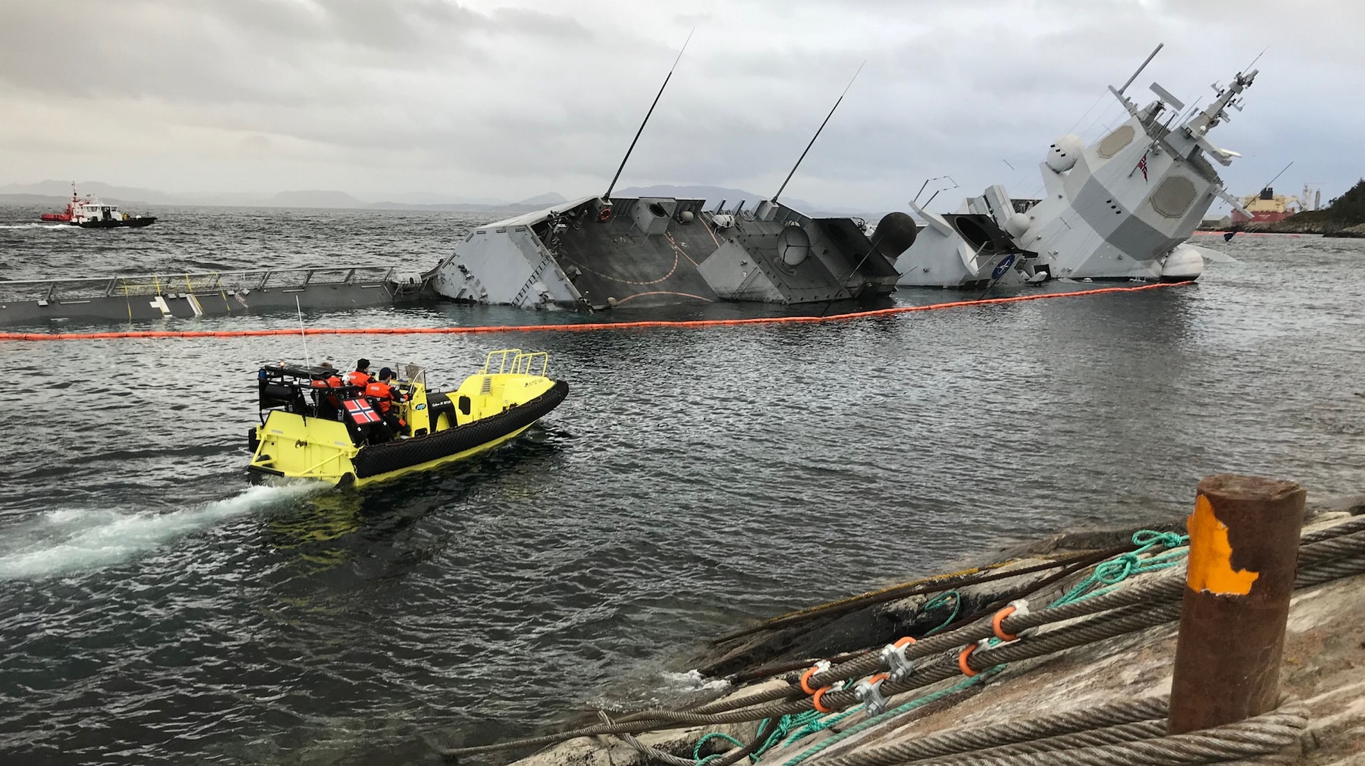

Here is a picture of the mooring arrangement to keep the wreck from slipping off the ledge it is resting on:
Solid granite comes in handy some times.
The work to secure her is ongoing. This former ferry support the operation:

Also - a bit off topic but I couldn’t help but notice some of the cable clamps on the wires are installed incorrectly. The ones installed the wrong way will crush the working part of the wire. - Never saddle a dead horse.
Looking at the simulation it would seem that the cartoonist was much more perceptive than I first appreciated with the tanker pictured through the windows on the starboard side of the bridge.
Beauty, thank you.
You’re so right I often see the clamps fitted wrongly, once on a pedestrian suspension bridge. There is also a correct number of clamps that should be fitted and a correct spacing of the clamps.

EDIT: Seriously wondering if incorrect wire clamping may have had a hand in this…
IMG_3423
I think that real salvage experts would have frowned upon the securing method and would have chosen another route to stabilize the wreck. The displacement and thus weight of the ship is 5290 tons and that is not going to remain in place on probably a steep rocky slope with these simple thin wires, it will start to slide or move by pure weight. Seen the rather sharp bend on the rocks probably chafing will kick in, apart from the wrongly placed clamps and the overload on the wires. Amateurs at work…
I guess they used what was rapidly to hand, but of course history now
It’s sickening to watch. First they managed to lay the vessel with the wrong side to shore, guaranteeing that it would flood with water, and then this shit job of securing it.
Yup and besides laying the vessel on the wrong side - they left to many water tight compartment doors open.
Well, I don’t think they had a say in which side went towards shore, since it seems that they instantly lost propulsion. As far as I can tell, it was pure luck and happenstance that she ended up where she did. Also, the open watertight door in the picture above is at the aft end of the casing, so I assume that it connects to the engine room which already was flooded.
That being said, this is a very sad spectacle indeed, and the result of an impressive jumble of mistakes. It maybe wouldn’t have been so catastrophic to lose one of the Fridtjof Nansen class frigates, seeing how they were already pilfering parts off some of them to keep others running, but it doesn’t even look like they’ll get many usable spares off this one.
They said at a press conference today that the anchor points started giving way before all the lines snapped simultaneously, so it’s a stretch to assume that incorrect clamping alone was the cause. However, it’s quite telling how rudimentary flaws in the securing arrangement were pointed out prior to its failure.
