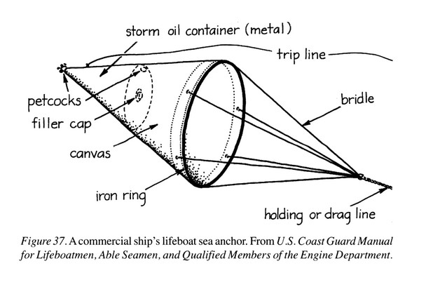

I believe that the storm oil carried in the lifeboats back in the day was to be dispersed from a container that was fitted into the sea anchor. The boat would be downwind from the sea anchor of course.

The USCG regulations also used to require that lifeboats be equipped with storm oil.
IMG_5533
