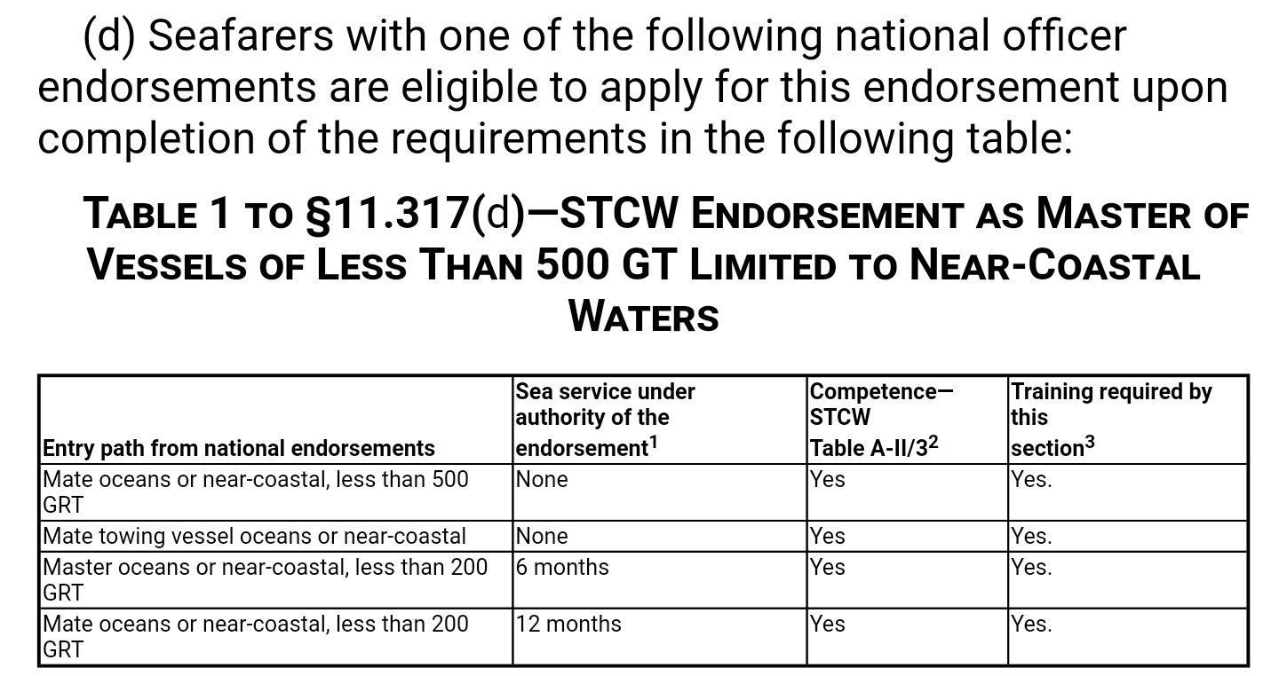

From looking at the CFR it looks to me like you need either a Master/Mate of Towing or a 200 GRT license to get STCW II/3. It’s not very clearly spelled out though so I may be incorrect.
I do not know, but logically, if the USCG can issue an unlimited license restricted to 2000 tons, then I don’t see why they could not issue a 200/500 ton license restricted to 100 tons or less.
46 CFR 11.317 Requirements to qualify for an STCW endorsement as master of vessels of less than 500 GT limited to near-coastal waters (management level)
(d) Seafarers with one of the following national officer endorsements are eligible to apply for this endorsement upon completion of the requirements in the following table:
They issue a license as mate or master of vessels not greater than 2000 GRT and to get that require you to take the exam for licenses greater than 1,600 GRT (the unlimited exams). It isn’t an unlimited license until the tonnage limit is removed.
If they did what you’re saying then he’d have to test for 200 GRT, like one does for a 150 GRT license.
This table is correct. However, I do not believe that it restricts the issuance of the endorsement to just those licenses.I believe that table is designed to provide a clear path/flowchart for the anticipated end user/applicants.

It may have to do with the exams taken and the 100 ton license may not have adequate exams to equal STCW standards.
Yes, of course, by taking the 200 ton exam. I hear that there isn’t much difference between the100 and 200 exams.
The checklist Rrayfield looked at is correct. It’s for less than 500 GT, (200 GRT).
All vessels on international voyages require STCW. If it wasn’t required for less than 500 GT (200 GRT) there would be no need for STCW Code Section II/3 and 46 CFR 11.317, 11.319. 11/321, and 11.323. For certain small vessels on DOMESTIC near coastal voyages, it may be possible to get an STCW endorsement without further obligation, see 46 CFR 11.301(h) and 46 CFR 15.1101(a)(2).
Training is required for all OICNW and Master STCW endorsements. The specifics will depend on the tonnage of the endorsement, and in this case, whether it is limited to near-coastal.
See 46 CFR 15.1101(b).
No. You can get the Master Less Than 500 GT endorsement with any national endorsement (license) as Master ( but not OUPV, as an “operator” is not a “master”). If you held a national endorsement for less than 100 GRT, you would be constrained by that tonnage limit even when operating under STCW.
