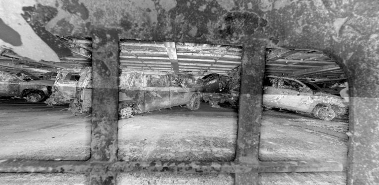

The detail of those LiDAR scan images is pretty impressive. I’ve seen it used for BOPs and piping systems but it seems pretty useful for this application too. I wonder if by “inaccessible cargo holds” that means for safety reasons or they were submerged. Looks like some hang-fire danger from the cargo that hasn’t broken free yet.
Yeah, I quit scrolling after reading about the rocks to slow the erosion, didn’t see the LiDAR images till now.
This photo looks like it was taken from inside a ventilation duct. Used cars I think based on the pickups have caps on them? Looks like they have shifted. Sometimes used cars don’t get lashed as well as new ones because the weights tend not to be calculated as carefully.
That LiDAR, just learned about that recently, used in forestry and mapping, almost creepy what they can see.
Also looks like they’ve burned too, unless they’ve started shipping cars with wheels but not tires.
Somethere there are some photos of some high-end German cars being taken off a car ship with a front end loader after the ship went thought some heavy weather. A lot of the tires had been torn off as well as wheels and whole axles.
That was after a lot of heavy rolling, this one only went over once but it seems possible the tires may have been ripped off.
