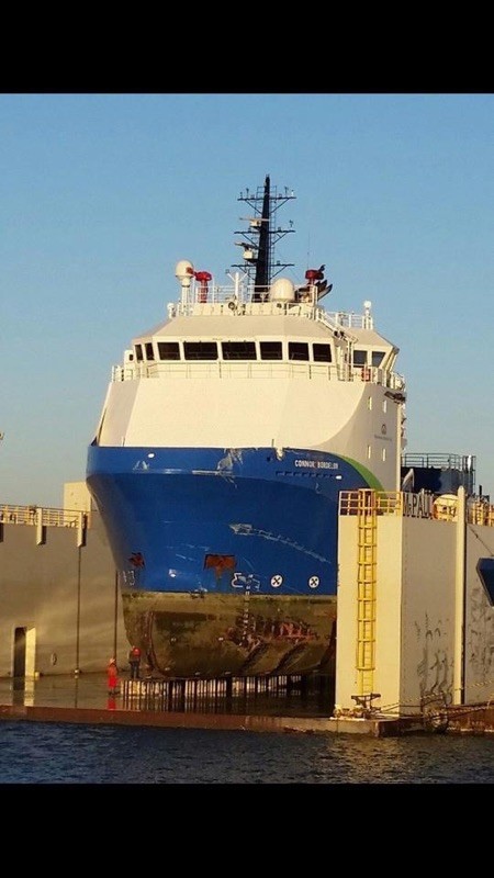

Here she is in drydock:
Looks like the allision tore a pretty good amount of steel off her bottom.
[QUOTE=rob;152817]Here she is in drydock:
Looks like the allision tore a pretty good amount of steel off her bottom.[/QUOTE]

Maybe it’s just me, but I think what looks like a gash is the growth in the bottom rubbed off and what looks like frames is just the frames printing through the steel. I just don’t see how you could have a gash that large and miss-shapen and have the frames still straight up and down.
I’m with you on that as well you would see some steel rolled up with a gash like that
Roger on that. There may be a penetration there somewhere but most of it is clean copper paint with some denting between the frames.

Just been scraping the waterline Cap, no damage here, sir. Have to keep that waterline clean!
Another picture I saw tonight showed an obvious bit of plating missing aft of that, but it was neatly cut out like they were cleaning up some buckled sections or a small hole for new steel
