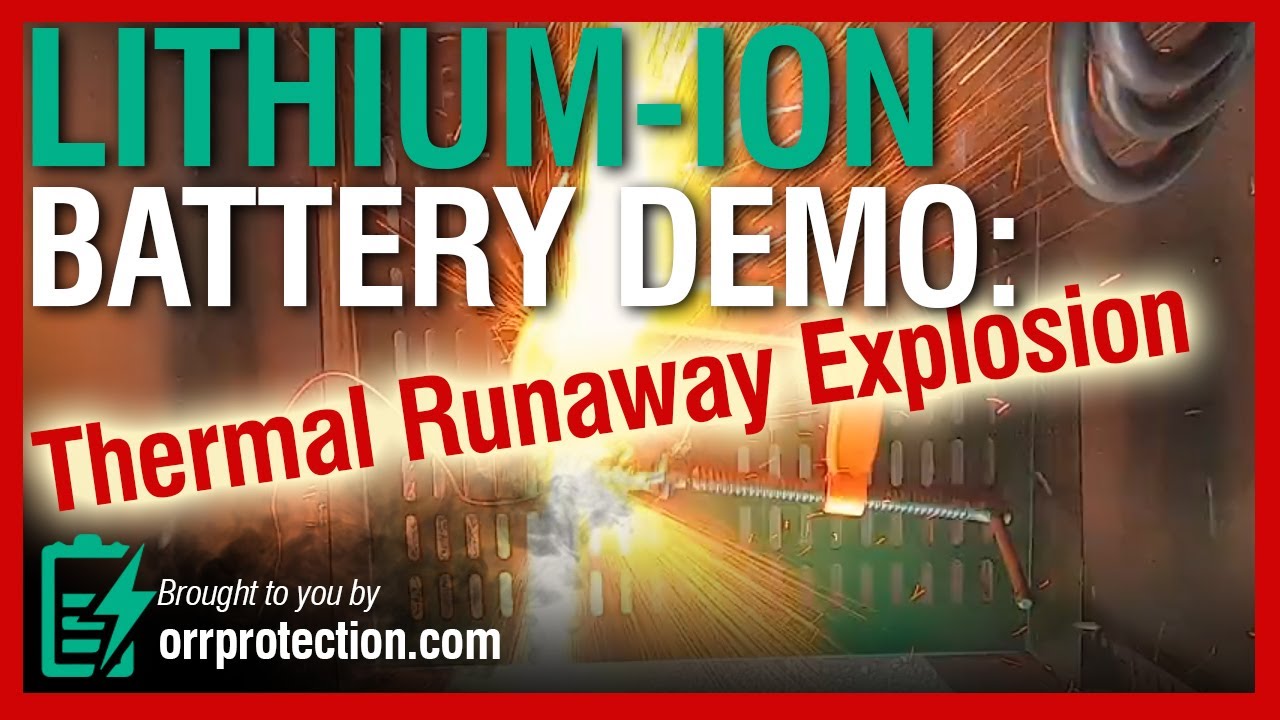

  • If so, would that reduce the risk of STARTING a fire, or would it just heighten risk of thermal runaway?: https://www.youtube.com/watch?v=hwXccpeN6Qc&t=3s
  • Will say <30% charge level be less risky than >50% charge in L-I batteries?
More specific explanation and demonstration or Thermal runaway:

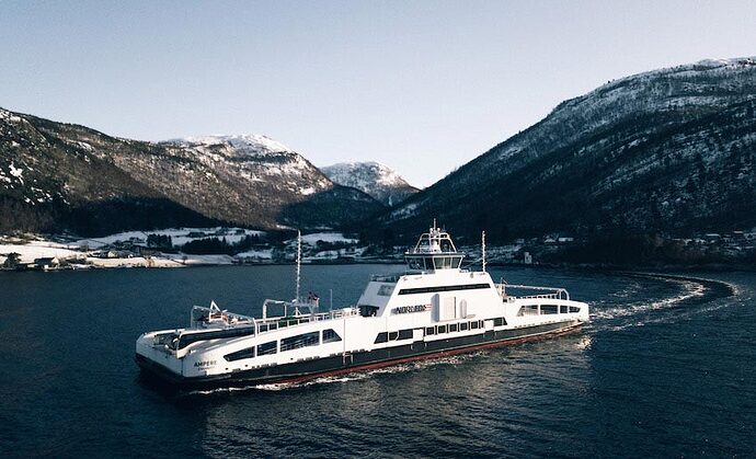

One more question; If L-I batteries are so prone to causing fires, or thermal runaway, why does this not happen as frequently in the large L-I battery banks found on more and more ships and ferries?:
The battery compartment on the car ferry M/F “Kommandøren”. Photo: Corvus.
This first electric car ferry in Norway MF Ampere has now been in operation over 10 years w/o any battery fire:

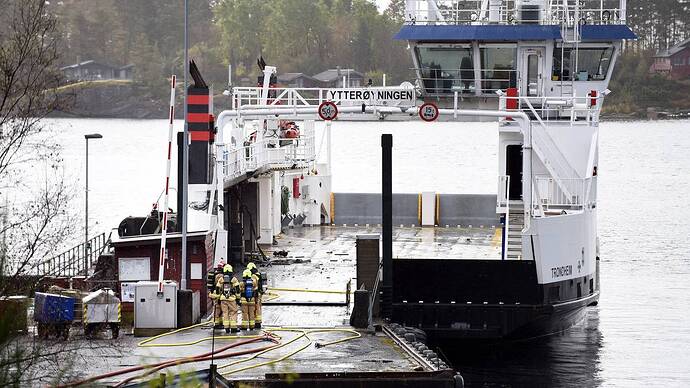

AFAIK there have been only one major fire incident on the many ferries and offshore vessels with large battery packs in Norway:
MF «Ytterøyningen» took fire at Sydnes ferry quay in Kvinnherad on 10 October. 2019
Source:
The reason for the fire was found to be:
PS> Lessons learnt, improved design and understanding of battery fires has resulted in improved safety since then.
