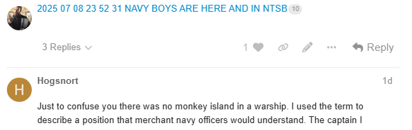

Hey dude.
Just look at this.
From above last it looks you have more Polish dudes here looking to whom the Hogwash bloke is talking to.
Next thing. Have run search " monkey deck "on this thread and have come up with below results :
My guess the Hogwash dude is confused and has either problems with concentration or is in continuous O.D. condition .

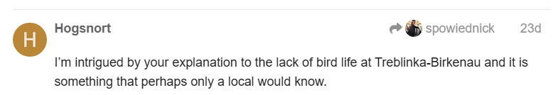

BTW. Have checked on this Hogwash fellow. Untill 23 days ago his responces to my profile/alias looked like below:
Since the last 23 d responses has changed to sth like below :
By comparison it means He or moderators changed sth. in the profile settings. For example hitting IGNORE BUTTON .
I do not give a ratts ass abt it but it demonstrates the mentality of this people . Imposing sanctions seems to be their favourable trick. Exlusion, shutting down, ridiculing, belittling , vague & veiled insults once they run out of arguments. Tipical woke bag of tricks. I do not need ignore button to ignore one moron , two or the whole flock . Let thenm think they are super duper smart. :wink:
