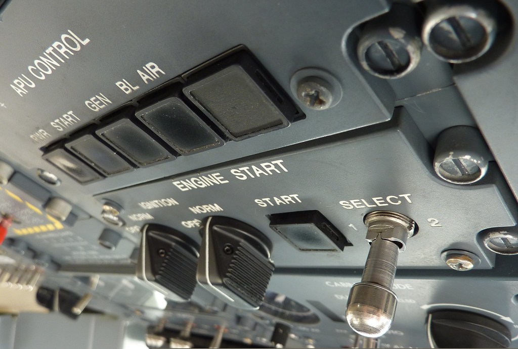

Although routinely used to shut down the engines I too was surprised to see that they did not have better guards on them.
Although it would not have prevented a deliberate act.

I seen two comments by type qualified pilots on 787’s . Both say there is a spring loaded gate on the switches and they have to be lifted before being moved.
That type of switch is used in several controls, particularly those used to select alternate inputs or outputs. Pulling the lever out before changing the state requires a positive action and is for all practical purposes, impossible to accidently change the state. The spring is strong and it takes two fingers (usually thumb and joint of first finger) to pull the lever over the gate.
