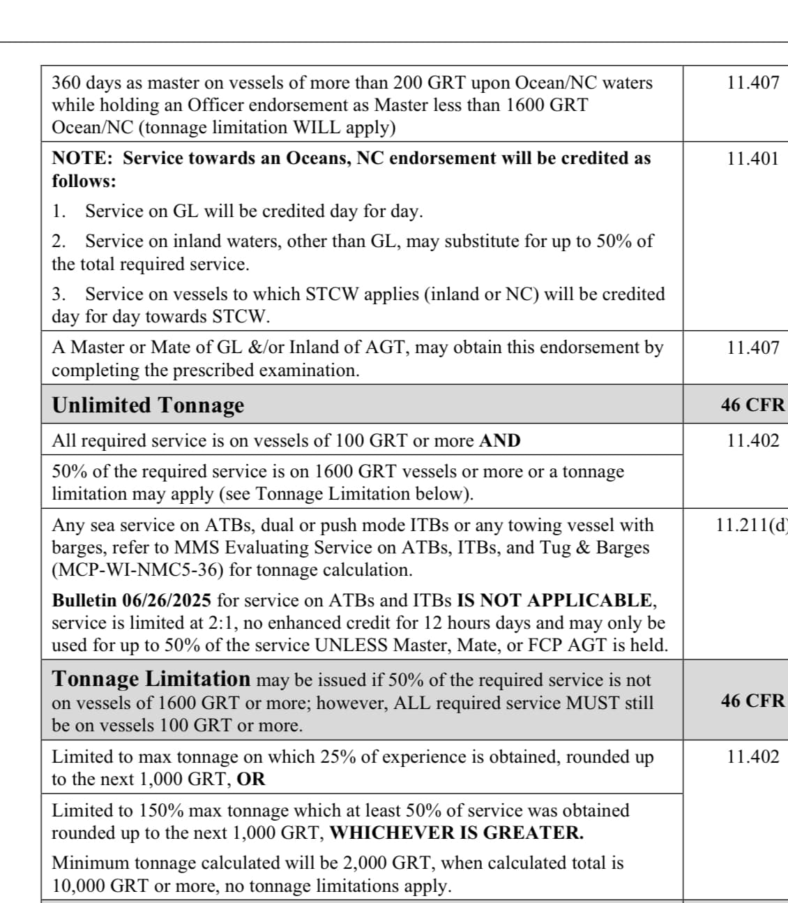

If I’m reading this correctly I can add 3rd mate, near coastal to my license since I already hold 1600 master, near coastal by simply submitting for it when I go to renew
Am I reading it correctly?
Correct
Sweet. I’ll never use it but I’ll be applying for it when I renew.
Looks like the only thing holding me up is 360 days as master on a vessel bigger than 200 grt.

It’s been 100 GRT since 2014. See 46 CFR 11.402(a)(1).

Thanks. I thought the checklist said the 200 grt condition, maybe I misread it.

It does say 200 GRT in the checklist, and that a tonnage limitation will apply.
I think it would be a 3M with a tonnage limitation though unless you meet the sea service requirements for unlimited. Am I reading it correctly??
Right..but that other link just says time over 100 grt?
Yes it does. The CFR quoted by JDCavo above says “all service” must be on vessels over 100 GRT, the checklist is referring to service “as master” of vessels over 200 GRT. (46 CFR 11.407) A wee bit confusing.
