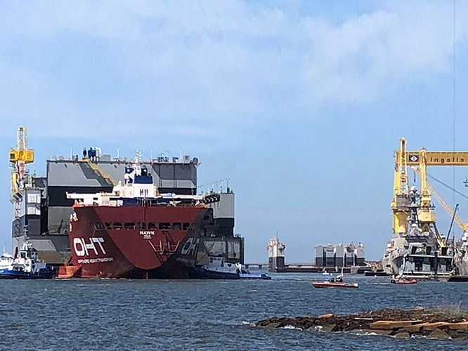

HLV Hawk allision with barge in Pascagoula
This happened in March, 2019, when the Hawk was approaching the “deep hole” just off Ingersole Shipyard where HLVs are able to “dive” to load/discharge cargo:
The NTSB Report was issued in Febr. this year:
