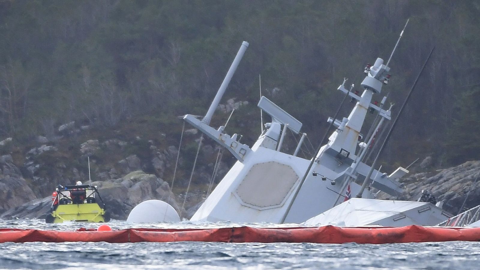

The main lifting will be done once the wreck is in position on the submerged barge, not by the cranes.
The damages to the hull and intact strength probably answer for the need to use two cranes with 4 main hooks to do the transfer from the present position to the barge, not the max. lifting capacity of the cranes with the booms in near vertical position and short range.
It doesn’t look simple to remove the wreck. It rests at less than 20 meters depth on its side. It is a total loss. 7000 tons scrap is worth say $1.5 M. Two big barge cranes lifting it, still on the side, on a barge is just a waste of time and money. You have to install plenty wires, etc, around it. So it is best to leave it where it is, in my opinion. I would just remove any guns, ammunition, fuel and oil aboard.
