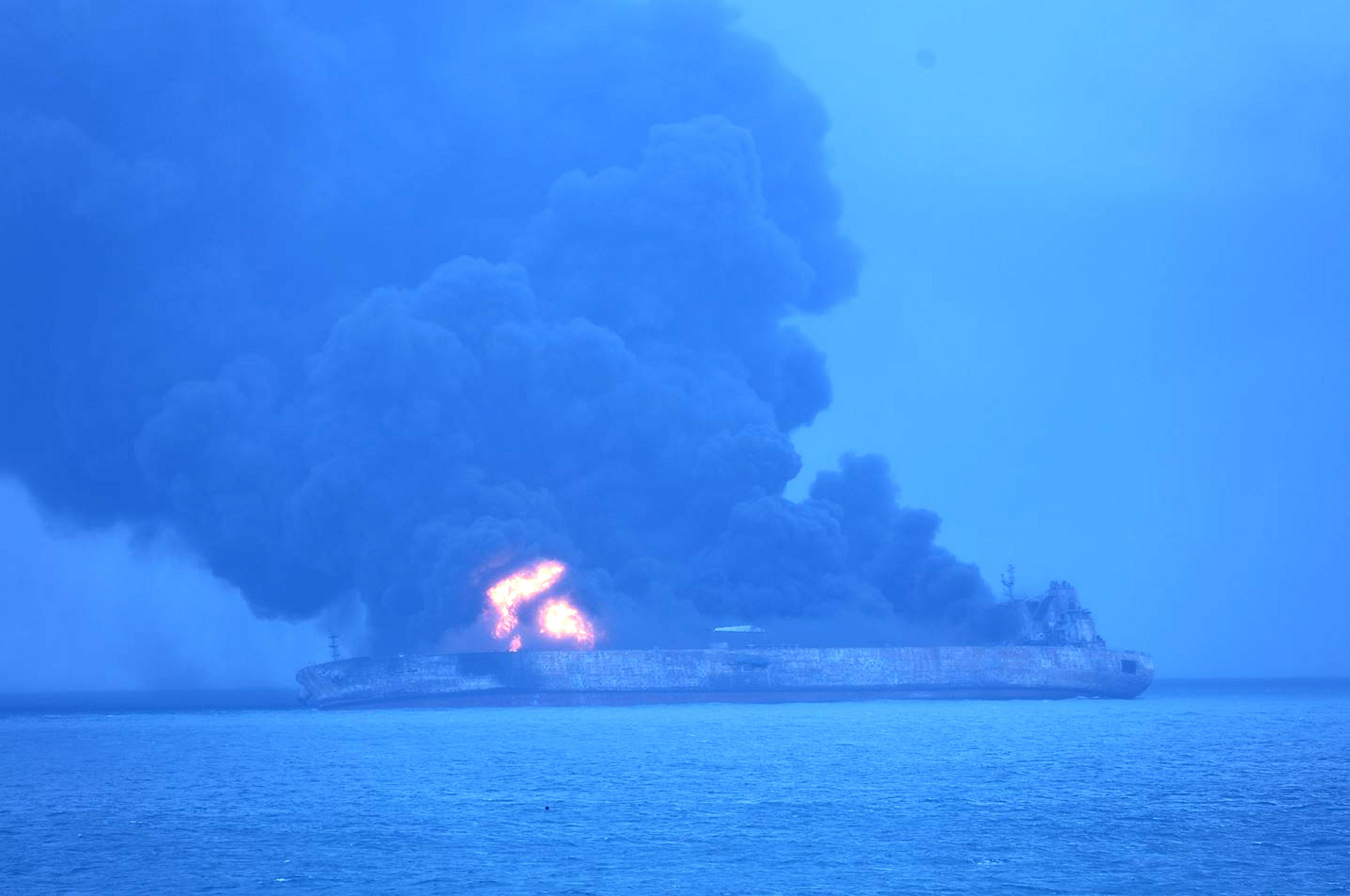

The Sanchi seen ablaze from bow to stern:

Condensate is a light crude oil , typical API between 45 to 75. I am hoping for some good news about the crew. I have 4 questions: 1) assuming double hull, why was the collision so devastating? 2) assuming cargo was inerted, why did all the tanks explode, as appears from photos? 3) Why could the crew not escape? It makes me think that the fire/explosion must have been devastating 4) How well are Iranian ships inspected and crews trained? But mainly, for now the crew must be in our thoughts.
The state of the tanker will be open to scrutiny.

Double hull does not protect from high-energy collisions.
Also as the tanker was loaded the ballast tanks would have been empty, AIS gives the bulker draught at 12.8m so loaded. Once the hill was punctured very little to stop damage to the double hull.

The safest place on a tanker on fire is actually the engine room. In this case the whole deckhouse was apparently destroyed by fire, incl. communication and lifesaving equipment but maybe some crew managed to escape down into the engine room. As the ship is still floating people may still be trapped down below.

Every photo published so far shows the paint burned off from stem to stern and if the machinery spaces got hot enough to burn the paint off down to the waterline the odds of anyone surviving have to be very very slim - nil in my opinion.
first image of that CNN article also shows quite a gash on the port side with (I guess) sea water gushing out of the double hull tanker

The safest place on an oil tanker is the engine room. If the engine room is on fire, it is protected, so crew outside is safe. If the outside is on fire, best is to take refuge in the engine room. No outside fire can hurt you there. I assume people on M/T Sanchi is still alive in the engine room.

Looks to me from the photos that there isn’t a speck of unscortched paint on the hull plating from stem to stern. God have mercy on their souls.
Well, the engine room is protected by A-60 fire insulation and the part below water is cooled down by seawater, so it is a pretty safe place, if the outside - oil on water (?) - is burning. The paint below water is still there!

“A-60” is just a steel bulkhead with enough fire insulation to keep the average surface temperature on the unexposed side below 140° for 60 minutes and prevents the passage of fire and smoke until the end of the one-hour standard fire test. After that you’re on your own. How many days has Sanchi been burning again? Five?
