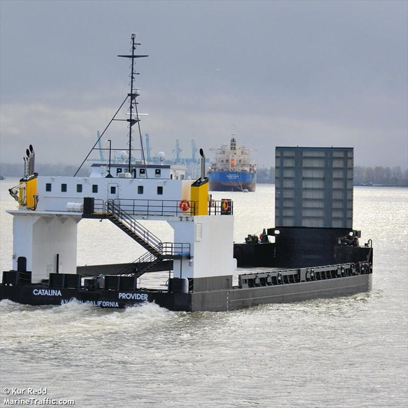

we got this in LA. Private terminal as well. Near coastal trade, but designed for a specific route. I just like the versatility of it so I thought I’d put it up here.
