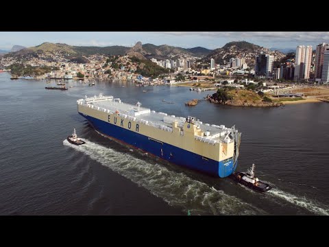

The ARC Endurance is still among the largest RoRo vessels in the world (#5):
The 330 tonnes SWL ramp is not unusual, or a record in the WWL fleet:
See video tour of one of the WWL RoRo vessels to get an impression of the size and capabilities:
The next generation of WWL RoRo vessels:
