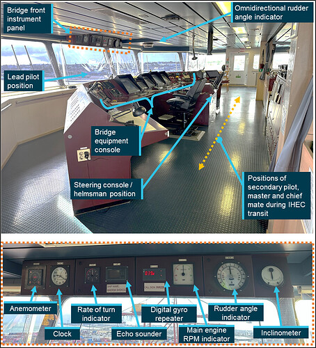

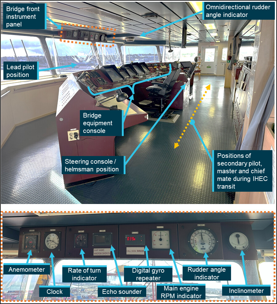

I’m navy trained. I never gave a helm order without also observing the rudder indicator in response. Nobody ever did. That was a strictly enforced standard particularly as the helm was rarely on the bridge in sight of the officers.
It seems there’s a total uninterest in monitoring the rudder through this entry. The large helm movements in the channel should have been noted by all as a sign of a problem. I would have been inclined to stop steering a course and reverted to direct helm orders then at least someone would have been paying attention.

Yes, absolutely. That’s a very basic requirement for anyone who has the con.

Not only the second pilot but also both the captain and the C/M had a clear view of the rudder angle indicator and of the helmsman.
