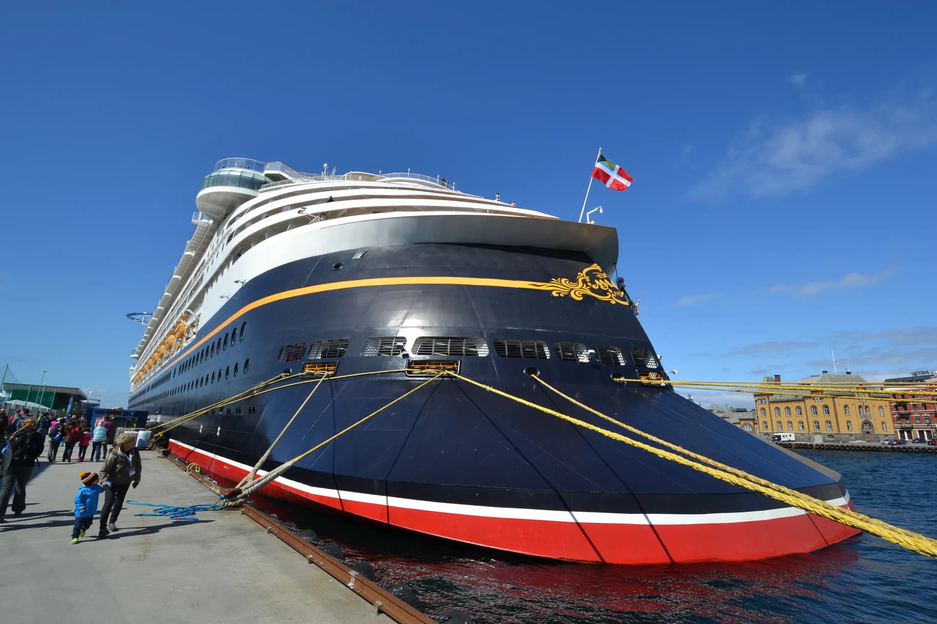

Some may have noticed that older cruise ships when getting a “makeover” tend to get an ugly look “appendix” (known as a “Duck Tail”) added at the stern?:
Some cruise ships have this feature from new:
Why add such an ugly feature to a ship you may ask?
Well, here is an explanation:
In this case the waterline length has been added at the bow, thus reducing resistance by changing the L/B ratio.
This give higher speed with a given engine power, or reducing the power requirement to obtain a given speed.
The last also reduce operational fuel consumption, which was mentioned as a feature for this design.
