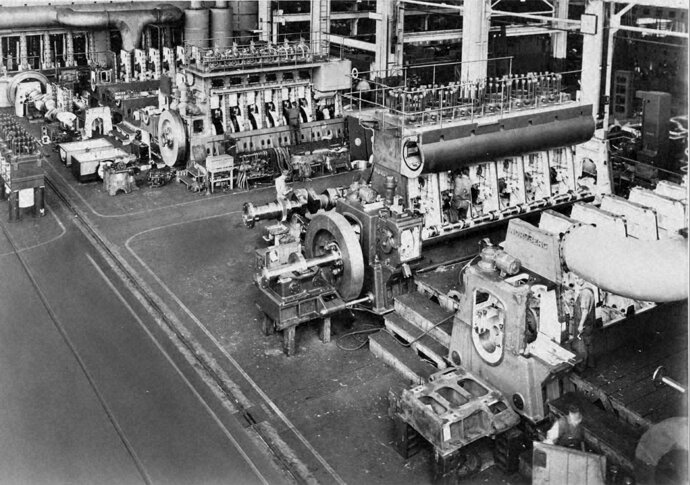

BTW; The first diesel engine over 10000 Hp didn’t come before abt. 1950.Made by B&W.
It was fitted in this ship:
Burmeister & Wain put a 22,500 hp engine in a Danish powerhouse in 1932…

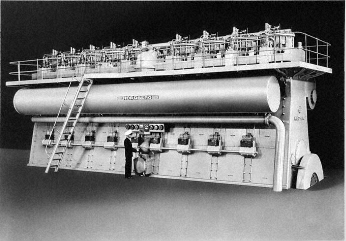

but we didn’t need to send any licensing money to anybody! there used to be US designed and fabricated slow speed diesel engines made right here in Milwaukee! but they ended up dying a miserable death…why is the question which nobody seems to be able to answer here
why did the USA end up throwing all of this away!
Just not competitive, got bought out by a Finnish company that made more money off rock crushers and stationary engines. Besides, wasn’t the biggest marine engine only 6,000 hp? Pretty low output for the amount of iron.
5850hp to be correct but remember the era? No turbo chargers on them engines…just a blower to provide scavenging air. what king of HP would this engine make if fitted with a turbo or two? 20000?

Yes, a stationary engine that is actually still in fully operational condition and started up once a month to be ready in case of a major blackout of the grid. It is the first start device to get back in operation:
When I was OS on board Theben in 1961/62 we were told that the engine installed there was “the first marine diesel over 10000 HP installed on a commercial vessel”, but I have no proof of that.
