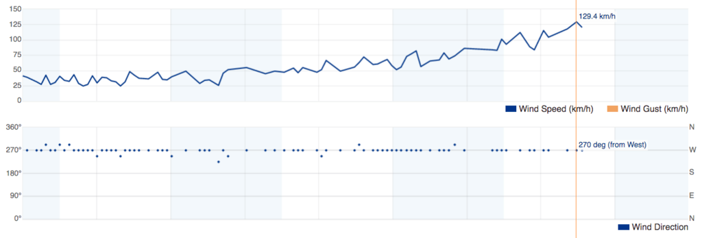

Weather History Graph for Crooked Island And Long Cay
September 30, 2015 - October 1, 2015
This graphic from the closest weather station to Sumana Cay illustrates how easy it would have been to work out that they were going to get a direct hit. The weather station [ICROOKED2] was knocked off air shortly after the 129.4 km/h reading. The pressure was falling steadily since midday the previous day; wind speed steadily increasing; wind direction constant (no veering or backing). They were clearly in the direct path of the storm.
If El Faro had been able to see their own graphic for the same period it would surely have set off more alarm bells.
