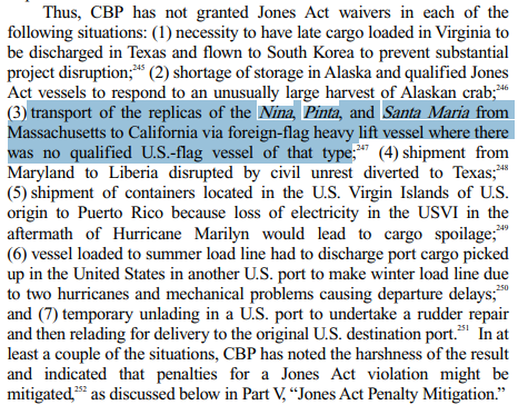

From the gcaptain article:
Looks like they puled out some old drawings to build a replica.

Are there any US flag semi-submersible HLVs or Dockships that could handle these ferries? (The hybrid/electric vessels will measure 409’6"x83’2"x24’6" with a draft of 16’-6")
Or will the Panama Canal crossing be enough to bypass JA restrictions for using a foreign vessel.

No, there aren’t any such JA-compliant vessels, and transiting the Panama Canal won’t solve matters. This issue has come up before: https://www.winston.com/a/web/156258/Jones-Act-Waivers-Article.pdf
