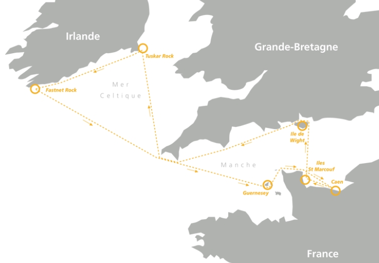

Was following this event. When I saw this course amendment (after the race had started!), I thought it was crazy. They cut out the legs around Tuskar Rock (in relatively quiet Irish Sea area), and substituted 2 additional crossings past the ends of the Ushant TSS to round Chaussee du Sein instead. Yes, the actual TSS was no-go but shaving the ends was the same danger as cutting across!
I hope that the Race Committee are held to account for endangerment.
The planned course - 2 Channel traffic crossings…
The actual course, eventually 6 Channel traffic crossings…

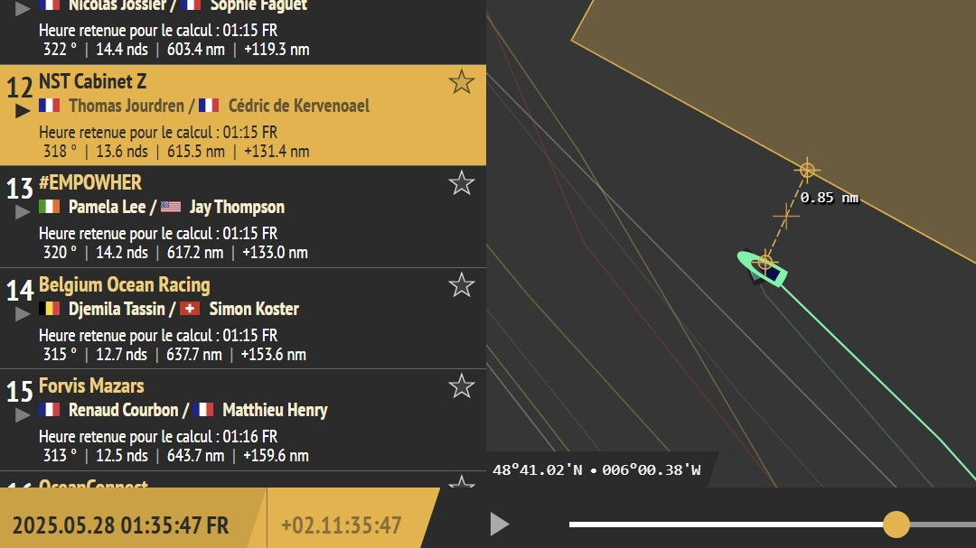

Agreed. 10 (f) & (h) were ignored completely. 10 (j) still applied because at the start of the interaction, the ship was still in the TSS, a mile to Stbd of the sailboat track (as per the race site tracker at the time)

Race tracker still online - actual distance off TSS 0.85nm
