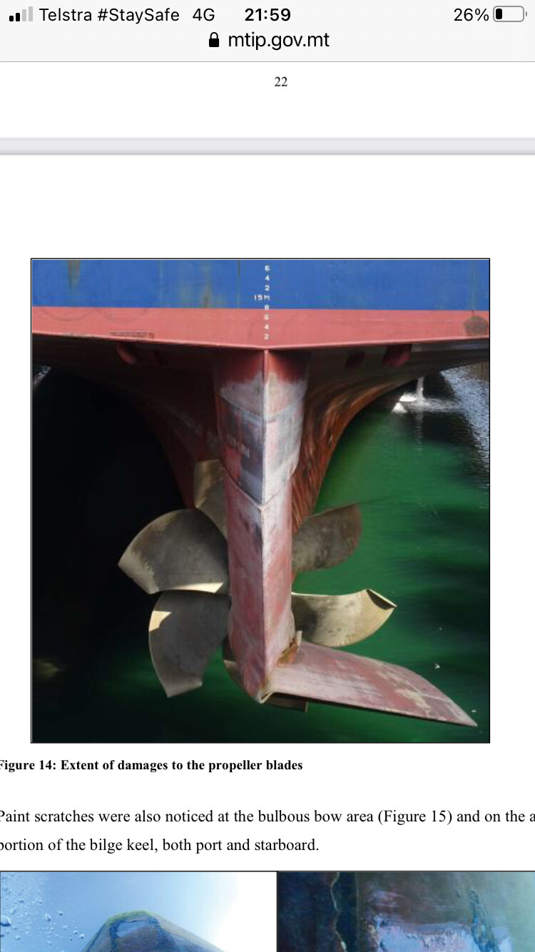

A similar incident took place on 19 April 2019 with the grounding of M.V. APL Danube in the Suez Canal. The APL Danube was approaching the km 133 mark in the canal when the vessel suddenly sheered to starboard. In an attempt to correct the heading the helm was ordered hard over to port and speed was increased, the vessel however, as is customary with this phenomenon, continued to swing to starboard and ran aground. MSIU stated in their report, as an immediate safety factor, that “The vessel suffered loss of directional power due to bank effect, since she was in close proximity to the Eastern bank of the Suez Canal.”
The Marine Safety Investigation Report is good reading material and can be found here.
It is curious that a month earlier the same ship under the same master on 29 March 2019 also experienced a sheer to starboard while Northbound through the Suez Canal, just before passing Bur Fouad Peninsula, which was deduced to have been caused by bank effect. Not strange as we can see her hugging the shore and cutting corners.
The ship was towed from Suez to Sokhna, Egypt, after the grounding and breakdown in Suez Canal on Apr 20. Reportedly, ship’s steering was seriously damaged by the grounding. The ship is to be offloaded at Sokhna and after that, put under repairs. She was en route from Istanbul to Jeddah.

Smaller vessel. 300/48/14.8m
Poor establishment of MPX owing to cadet escort complaint. Apparently the SCA “rules” dictate that a responsible officer attend. Pity this does not apply to speed and towage requirements.
ECDIS route remain turned off by second canal Pilot. Pilot navigated using an EC overlaid X-band radar.
Benign conditions. 10 knots SOG.
No mention of PPU.
No escort tug.
The helmsman alerted the bridge team to the starboard sheer. Sheering to starboard with hard over port rudder applied.
Rudder and steering gear severely damaged and frozen.
Propeller severely damaged.
Turning gear damaged.
Crankshaft damaged.
Forward plating damage.
It just reinforces my belief that there is little SCA procedural control.
