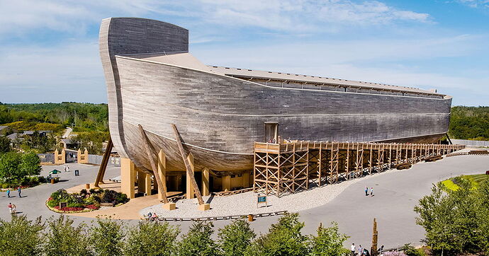

When it comes to basic stability, it doesn’t get simpler than these written plans from 4,500 years ago?
Best thing is the guy built a boat that had enough room for 8 people, all the animals of the earth and provisions to last the people and the animals until the water receded AND those 8 people managed to repopulate the earth in about 4300 years. Assuming 4 men and 4 women they and their offspring were very fertile. :wink:
and you can visit it and see how it was done for only $125 !!
And the straights, deepest and fastest oil & gas wells drilled in the North Sea has been drilled at “Dickens” in Stavanger.
Any stability problems to report on this Ark?
only on the visitors - Many are bottom heavy, others quite stiff. Though none have any navigational issues - they are 100% sure where they are going.

My linked article in comment 2 was an interesting read imo. While I used the words “basic” & “simple”, there’s nothing basic in the article after the first few paragraphs. Not being a big stability guy myself, the study on those plans from 4,500 years ago gets complex & comprehensive fast. They even took the time to build several miniature replicas to test.
