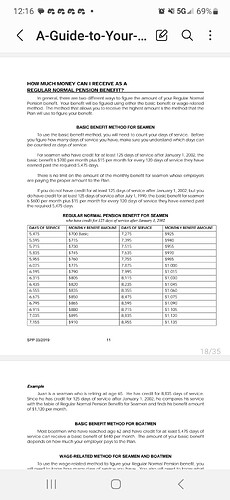

I would advise against it if you want to stay sailing deep sea. You have to start with AMO within a year of sailing with SIU for your pension days to transfer over so if you go to OSVs for a bit in the interim you’ll screw yourself on the long run.
Any they wonder why young people don’t want to go to sea.
That’s only the basic benefit, not the income based benefit.
AMO is a defined contribution plan and the contribution is a percentage of income based off of time in the Union. SIU pension days count towards time in the Union and that makes a huge difference.
