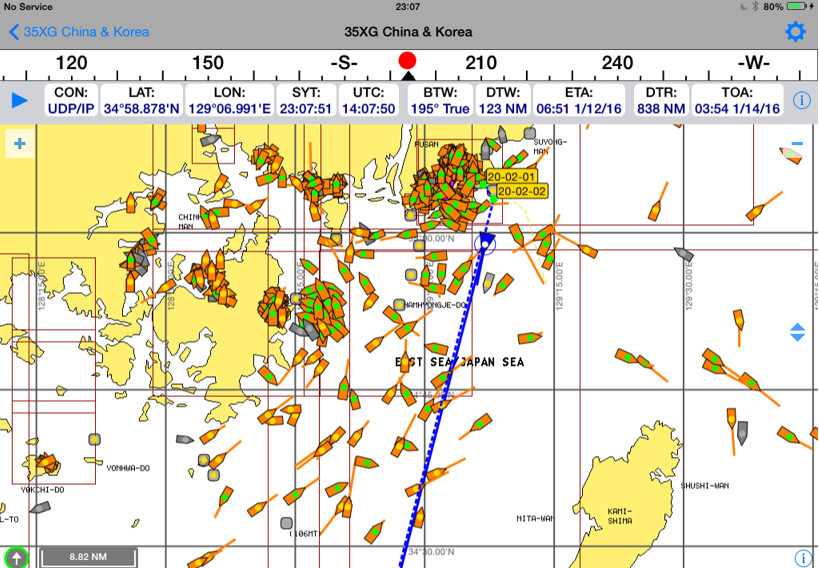

Here’s a screen shot from my IPad running INavX which I usually kept in my cabin - Leaving Pusan:
Range scale lower left.
The issue is for inexperienced or poorly trained deck officers - to a person with only a hammer everything looks like a nail. New officers don’t even know they have a tool missing.
