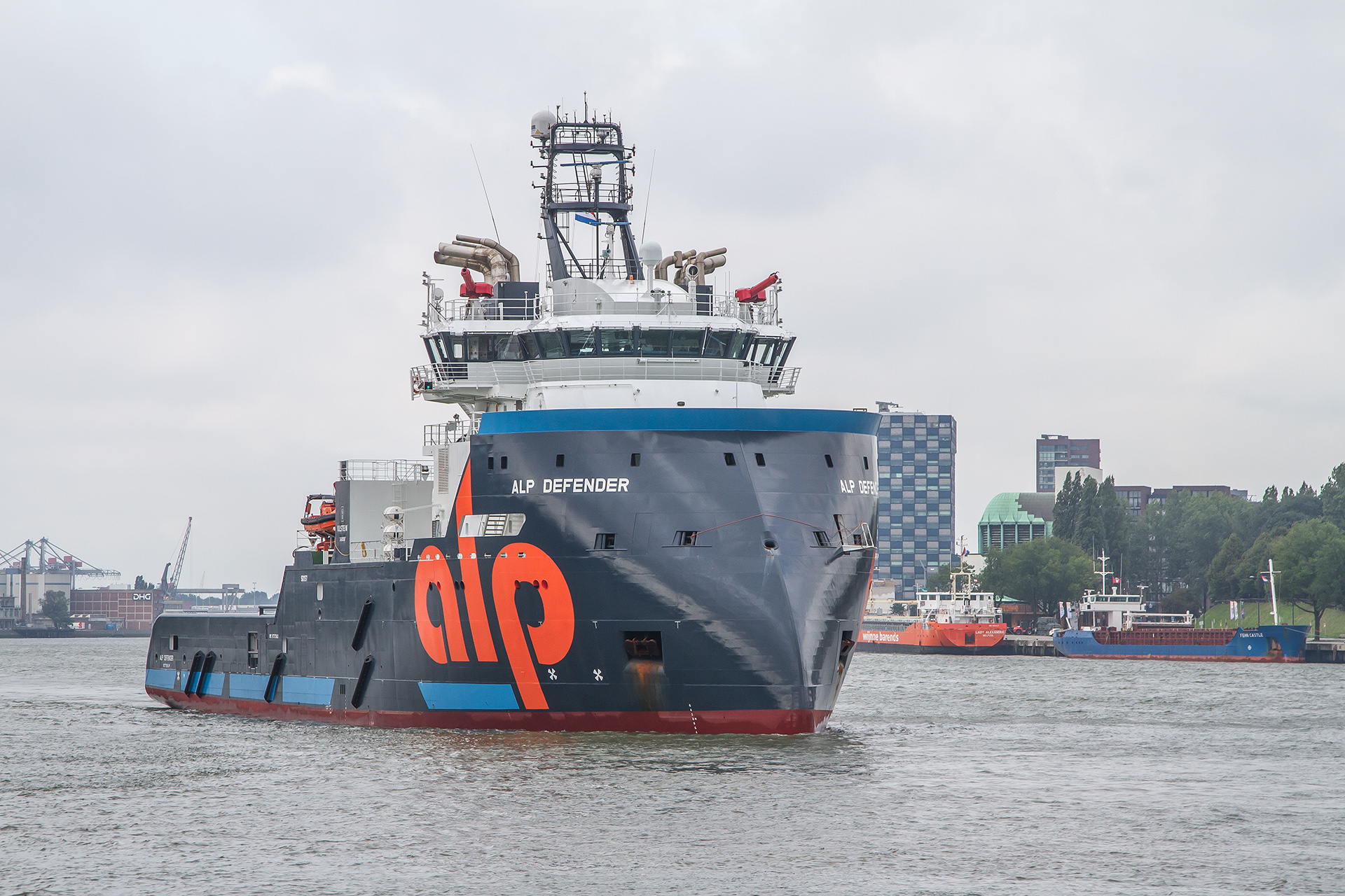

The huge oceanic tug ‘Alp Defender’, coming from Port-Gentil / Gabon, is now waiting or anchored near ‘Stellar Banner’.
Dutch tug Alp Defender with 305 mt continuous bollard pull.
Maybe someone knows what this big tug could do there.
I don’t speculate anymore how the salvagers could proceed… they always come up with surprising ideas…
