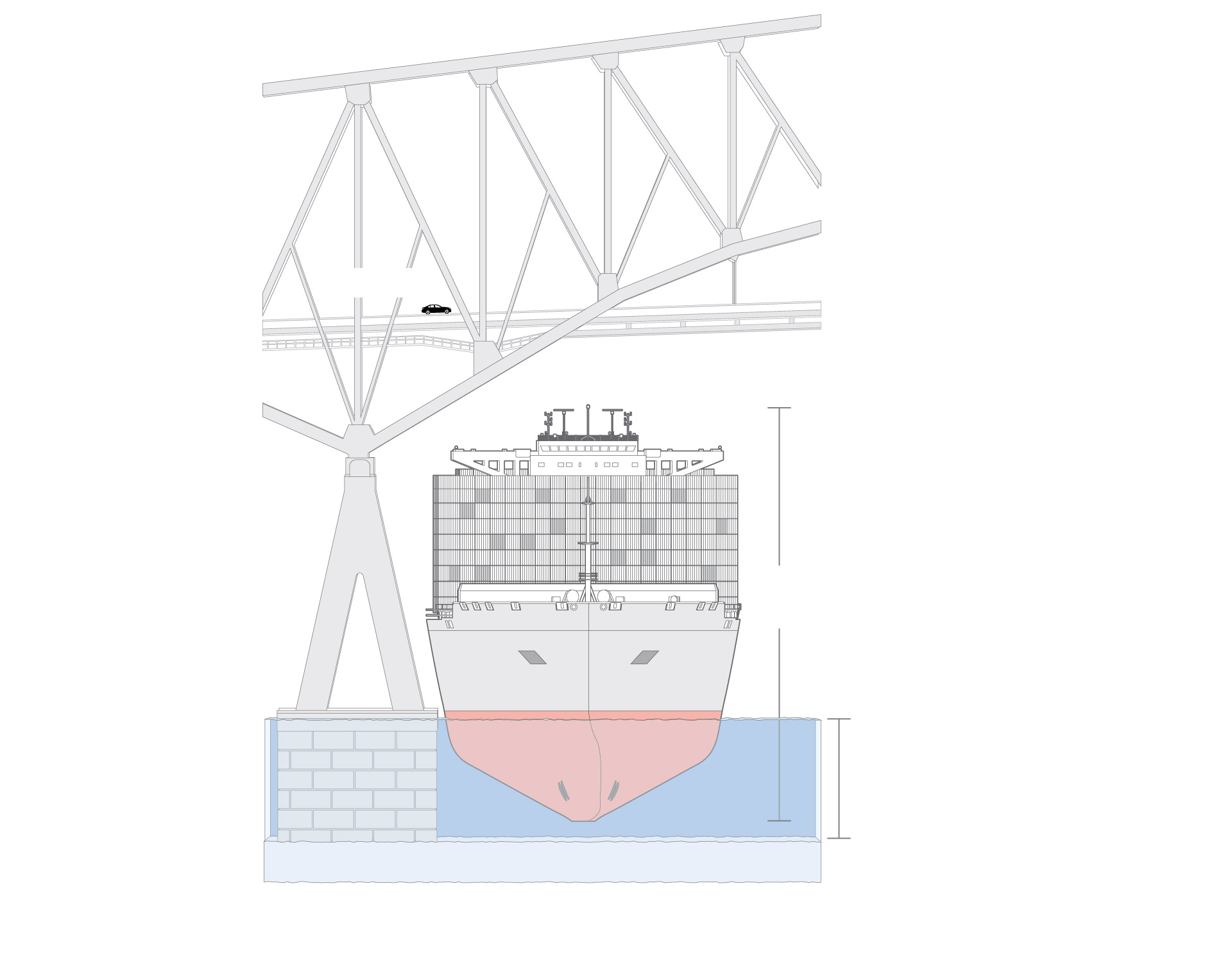

The Key Bridge support structures:
Francis Scott Key Bridge. Clearance at point of ship’s impact: About 185 feet
Sources: NOAA, balticshipping.com, Maryland Transportation Authority

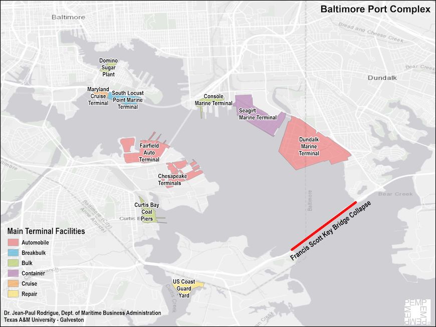

The economic impact of this incident will be felt immediately:
Source: Dali crew hailed as 'heroes' as details emerge of deadly Baltimore bridge smash - Splash247

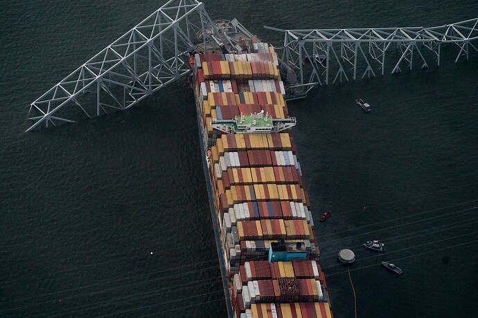

NTSB has released drone footage of the ship and bridge. Its going to be quite the undertaking to free the vessel from its current spot with the bridge, at least one of the support pillars and the road deck on the bow.

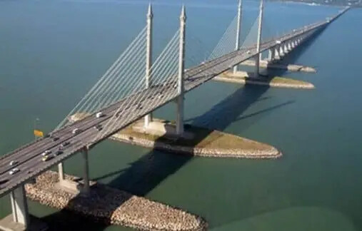

There also appears to be an absurdly small amount of dolphin cribbing around the supports for such a heavily trafficked waterway.
I noticed myself that the high wire line towers have much heavier protective concrete fendering than the bridge structure does.
Probably built more recently to a higher standard
