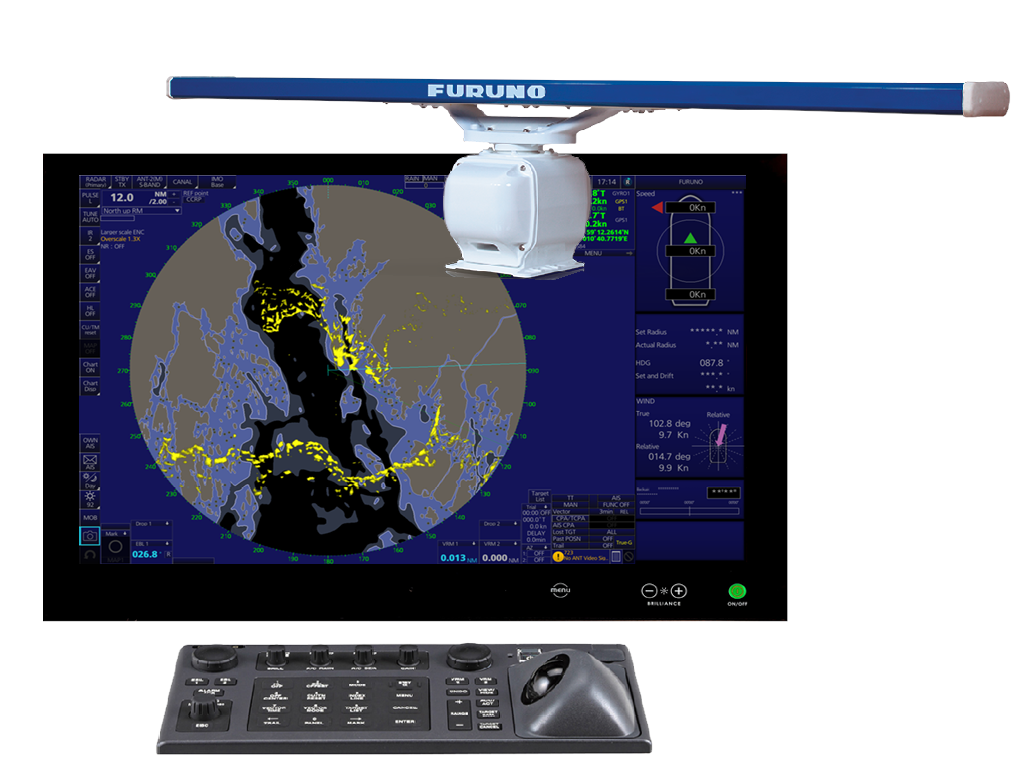

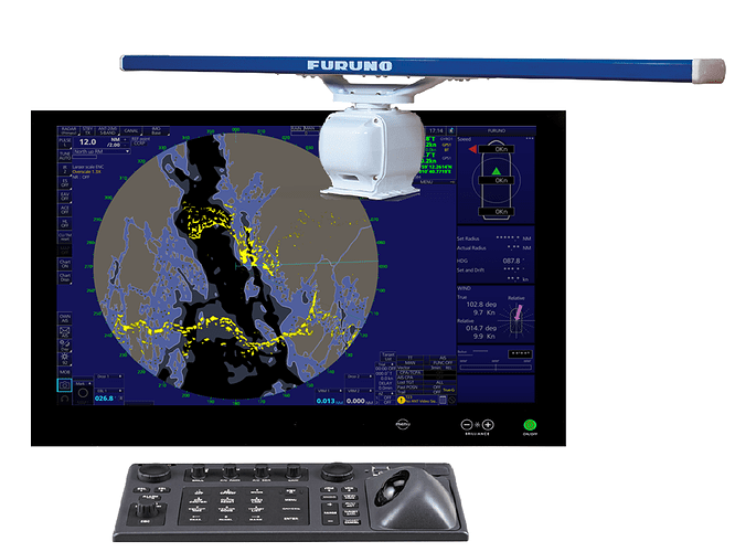

Some radars are capable of storing so-called "charts. The boundaries of the traffic lanes can be entered and saved in the radar and then displayed, we used to do this in Singapore Strait where traffic makes the workload high.
Also distances can be picked off the ECDIS and parallel indexing can also be used on the radar for distance off or to mark the turns.
EDIT: The charts on radar require GPS but not ECDIS, the parallel indexing only require radar, don’t use ECDIS or GPS.

Furuno has both X and S band Chart Radars
