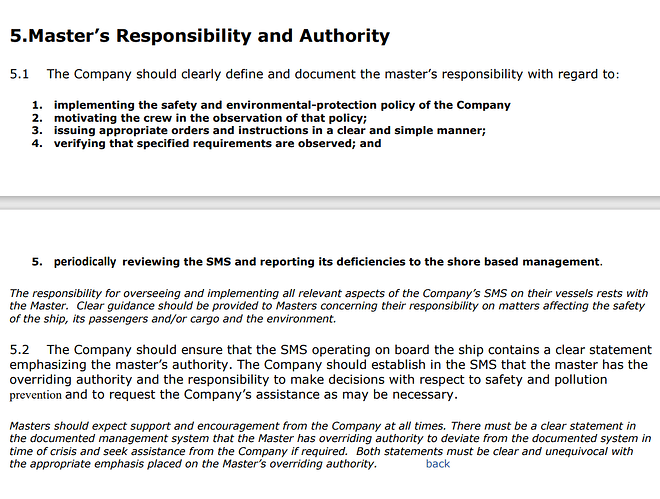

QUOTE:ISM 5.2 – The Company should establish in the safety management system that the master has the overriding authority and the responsibility to make decisions with respect to safety and pollution prevention and to request the Company’s assistance as may be necessary. END QUOTE
Was DPA on vacation all the time??
Above is a nice ISM manager bail out, on condition the master did not take measures HIGHLY recommended by the agent 007 what He should .
What about acting under “duress” ?? , like intensive almost debilitating commercial pressure from the Big Blue Operator?? .
Even if master reported such to his Principal “the Manager” , chances they would support him or act in anyway were minimal, as for them having a client like Big Blue as time charterer, looks fantastic on their chartering “resume” and is like being anointed by the maritime Pope . ( I have lived through experiences like that) .
But then, insurance fellow may ask the “informed ” Manager – what has happened to the old “good faith ” principle? – we should know!!!.

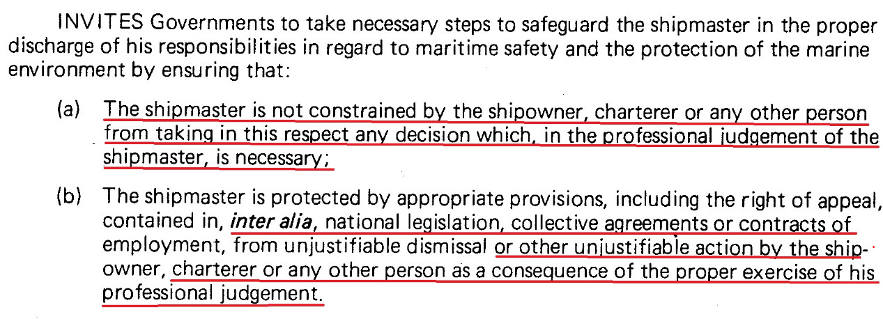

And this is the last moment you can show the middle finger to unscrupulous Managers as Your clean slate is more important, then effing criminals financial gains. With clean slate one will always get a job, better paid or worse but will get.
The moment You are ready to let go lines CL 26 as per below kicks in , then I am the King Kong :wink: .
You may peddle any BS to furious managers ; that something poped up during pre departure testing , that BT coughed :wink: , some reefers farted - U NAME IT :wink: . You are in doubt , You have the right and obligation to check again to be 100% sure.
The Pilot will very calmly grab the VHF and call USCG :wink: and i will offer him some danish cookies and coffee blinking with my left eye only.
And He would understand immediately what is going on. :wink: .
Big Blue willl shrug it’s shoulders, their Agent will make some inquiries and both will start clocking the offhire time immediately , 35 K usd or much more per day and pro rata, plus cost of pilot and tugs on stand by .
This is how easy it is done.
The Owners can not fire you for this, as You have a valid short-shit time toilet paper contract, and You are protected thus by Resolution A(443) as per below. But U already know, that when on leave they will not call U any more . :wink:

Now compare it to a pitiful descriptions in ISM code :joy:
This is PATHETIC how the immage and former “glory” :wink: of this position has been reduced , belittled and raped by the effing shore side slackers.

For almost 40 years |I have observed and WITNESSED live show of the systematic and systemic breeding of SILENT AND OBEDIENT LAMBS in my FOC environment , that could be blackmailed, manipulated , steered and later on scapegoated and dumped like a bag of rotten potatoes.
Master in this environment were converted to mere FETCH DOGS . We are stray dogs without the “master” .
