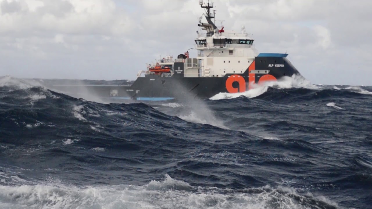

Add X-Bow and the problem with crew comfort in bad weather is reduced, if not eliminated:
Work in progress to develop emission free version:
Not familiar with the advantages of X-Bow? Here is a video for you:
What do those who have actual experience with X-Bow say:
https://ulstein.com/blog/statements-from-x-bow-users
Yes, keep on working, work sets you free…
Regarding that video, you would think that they would have been able to show it in action in some actual heavy sea conditions. In every video segment except one, the sea is so flat my dinghy wouldn’t rock.
Enough??

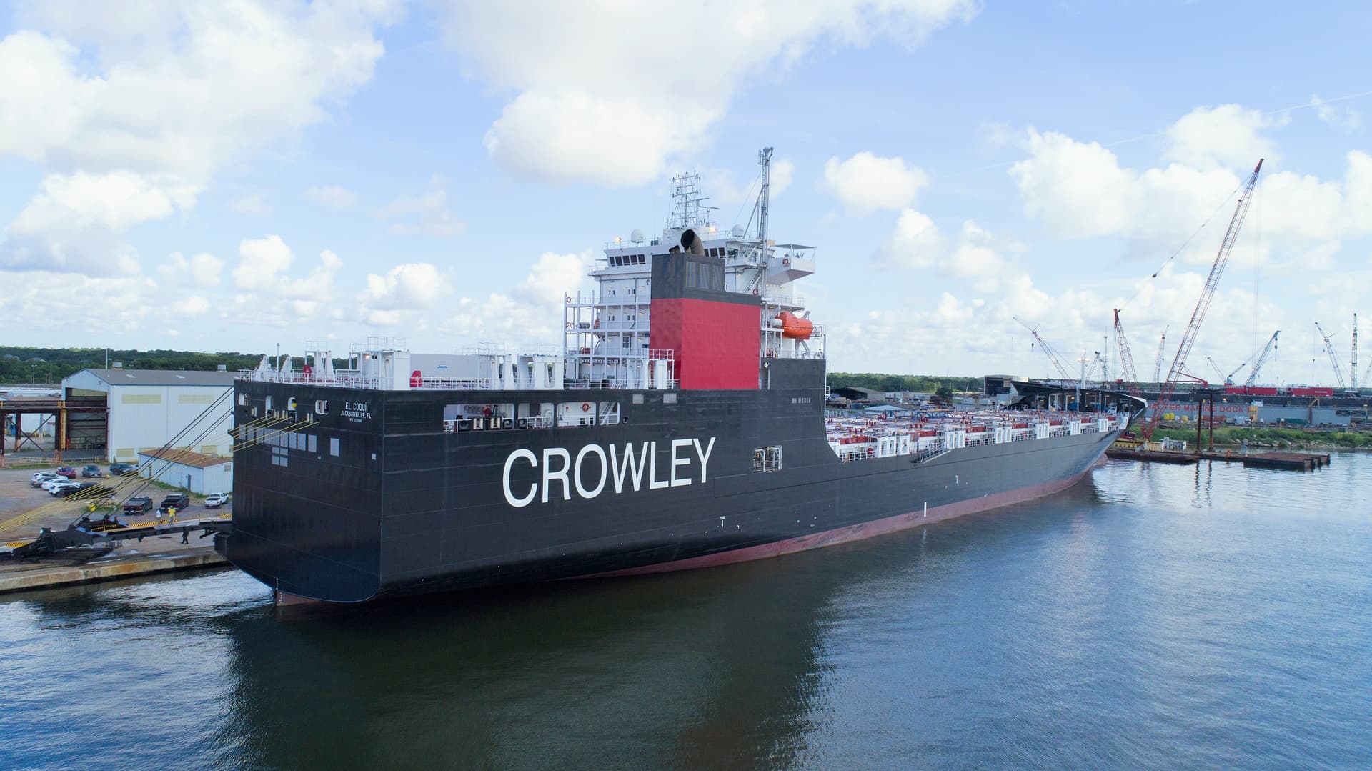

I think they should make the bridge taller than the container stack and/or bridge wings to increase visibility. Having worked on forward house ships, they all but eliminate vibration from the engine so you can sleep better BUT in a storm you will feel the pounding much more. So its a give and take. Also with methanol being potentially dangerous for the crew maybe that is why the accommodation is forward? Someone told be those new LNG Crowley ships leak gas i and makes the crew nauseous- don’t know if that is true. Does anybody have info on gas fueled ships with Crowley or another company does this happen?

While the vent mast is located just above the open bridge wing, somehow I doubt it would continuously leak enough gas to make the crew nauseous unless there’s something seriously wrong with the gas fuel system because the gas should be quite diluted by the time it reaches the bridge wing. A significant leak elsewhere (e.g. engine room), on the other hand, should set off an alarm.

I have sailed in an X-bow vessel and they are much better than conventional vessels in a head sea. Over the years I have had to adjust from all aft 400,000 dwt tankers to Ro-Ro and AHTS where the accommodation was forward. You adjust.

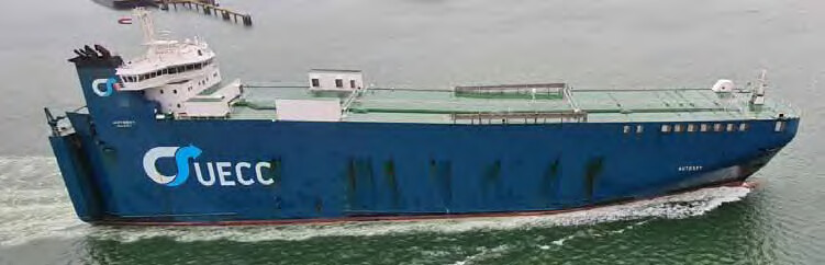

Looks like someone has take heed of the complains about forward house:
The AUTOSKY outbound navigating the Caland canal passing Heerema’s SSCV THIALF
Photo: Fred Mos o/b SSCV Thialf ©
UECC have also taken delivery of the first dual fuel/battery hybrid PCTC:
With the house a bit further aft than most PCTCs
