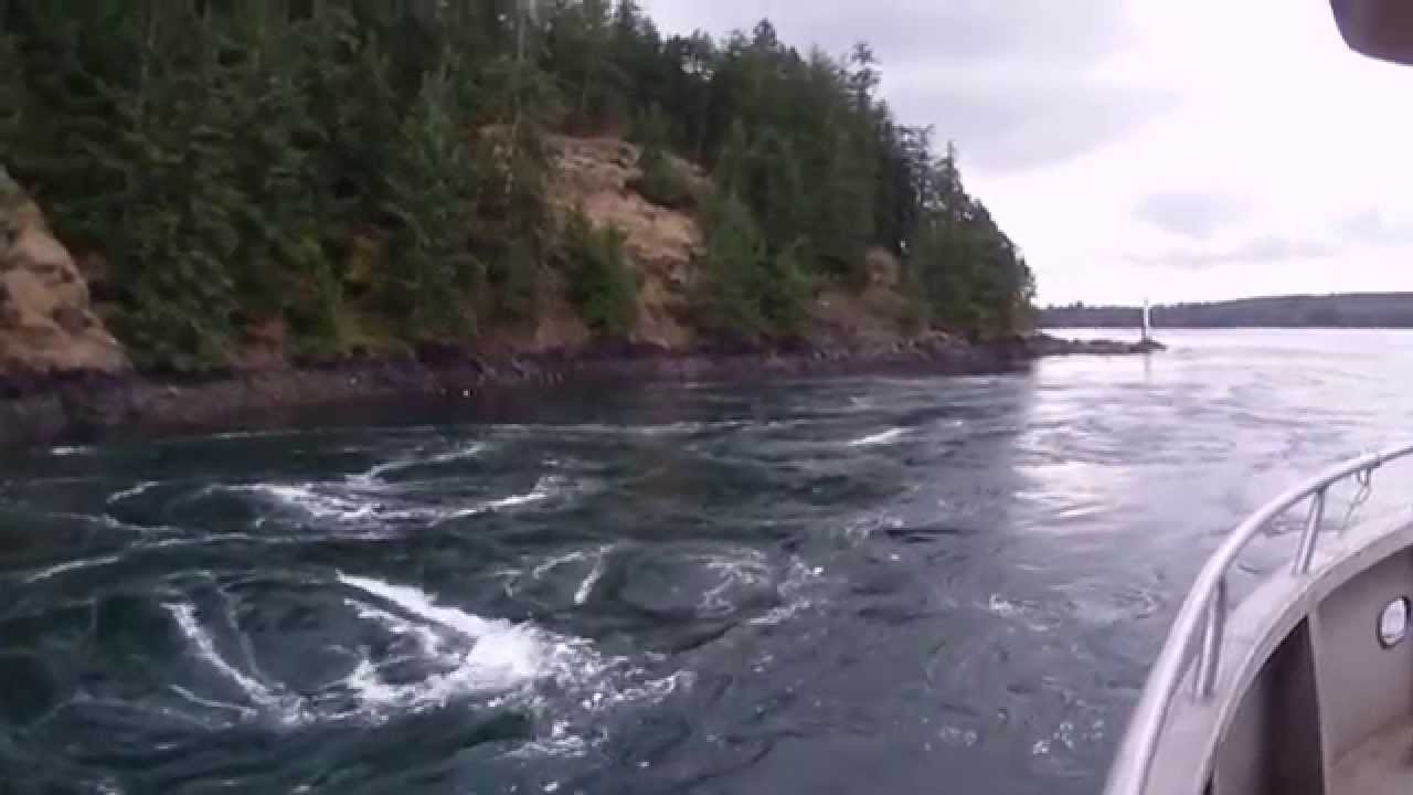

Seymour Narrows is notable also because the flowing current can be sufficiently turbulent to realize a [Reynolds number]i.e. one hundred million, which is possibly the largest Reynolds number regularly attained in natural water channels on Earth (the current speed is about 8 m/s, 26 ft/s, the nominal depth about 100 m, 330 ft).[4] Turbulence develops usually around a Reynolds number of 2000, depending on the geometric structure of the channel.
From Coastal Transportation’s training manual for new navigators:
…Seymour Narrows is one of four salt-water rapids which mark the divide of tidal influence between the Strait of Juan de Fuca to the south and Queen Charlotte Sound to the north.
For the navigator this concept means that the directions of ebb and flood on one side of the divide is opposite that on the other side, something to be kept in mind when working predictions of tidal currents. And the salt water rapids themselves, though short in length, are highly turbulent and constitute the chief danger on the Inside Passage. At full current the surface of the rapids will appear to be boiling with cells of whirlpools.
All traffic on the Inside Passage is timed to the four daily slacks of this line of salt-water rapids along the northern rim of Desolation Sound.
Seymour Narrows is the only one of these rapids permitted by company regulation to Coastal Transportation vessels. The other rapids are too small for routine navigation by our vessels. They consist of Yuculta Rapids, Surge Narrows/Okisollo Rapids, and Hole-in-the Wall/Okisollo Rapids. The only company use of the smaller rapids is by the training boat for training new navigators in tidal hydrology.
CTI vessels must only use Seymour Narrows at or near slack and when the predicted velocity of the water does not exceed the ratio to vessel speed specified in the standing order Seymour Narrows Transits.
The slack at Seymour is notional. The current never really stops. Consider it one giant eddy composed of small eddies and whirlpools which at slack change direction in a complex pattern over a few minutes.
Non-displacement vessels have little trouble with this confused water. Coastal freighters, tugs, and cruise ships are continually spun off course even during ‘slack’.
Going through with the tide behind you reduces your ability to maneuver around opposing traffic. Trying to stem a strong current decreases your chance of forging through before the current exceeds vessel speed, forcing the ship backwards. Reversing course at that point can result in a maneuver throwing the vessel in risk of collision with opposing traffic.
Because commercial traffic uses the narrows almost exclusively at slack, miles-long traffic jams of vessels can line up on either side of the 1/4 mile long narrows timing passage to slack, and all passing through within a short window of time. These include everything from log tows, cruise ships, yachts and kayakers…
