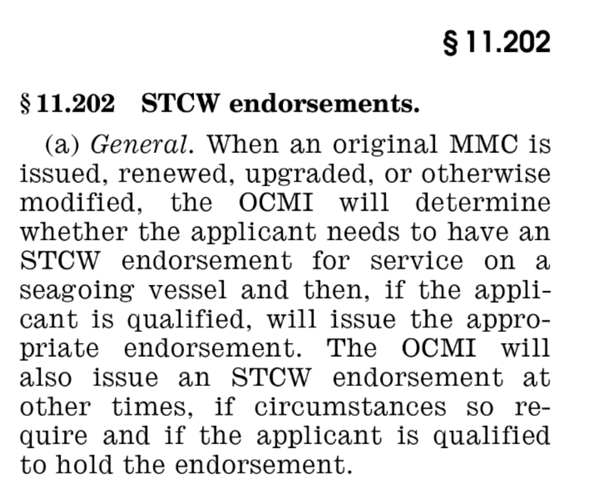

It was first published in the federal resister December 2013 and was published in the CFR in March 2014. AFAIK, it was covered under the same grandfathering as all the other STCW changes from that same rulemaking so it didn’t go into effect immediately.
Here’s an excerpt from the 2012 version of the CFR.
There was no separate section giving requirements for the STCW endorsements, as long as you had the required training and assessments and the corresponding national license you were given the appropriate STCW endorsement.
The most obvious giveaway is me saying it’s from the 2012 CFR…
