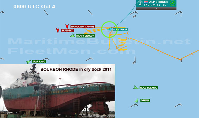

What I see in that picture is a bunch of rust spots on the freeboard that were knocked back (with a 3M wheel?) for painting. It makes me think someone said “make her look presentable”, which is materially different from the ever so tangentially related “make sure she’s sound”.
What I also see in that picture is a suspicious looking brown sheen under the waterline. If that’s what I think it is, then she’s well overdue for blasting down to the plate and re-coating. I’m not saying that it wasn’t done after the picture was taken, but who in their right mind doesn’t hit the freeboard when they’re at it? Neither am I saying that I know what I’m looking at, I’m just speculating…
Plate adjacent to drives and other skin penetrations are prime corrosion sites, due to the different alloys involved.

Another picture (undated) of the Bourbon Rhode drydocked. (Lifted from Vesseltracker):
I bet, they will dig into the dry-dock protocols, searching the reasons for the sudden water ingress.
Speaking of dry-docking, BV/VeriSTAR record shows Annual & Intermediate surveys on 13&14 Sept…

BOURBONRHODE8
This is from the Maritime Bulletin in this post.
