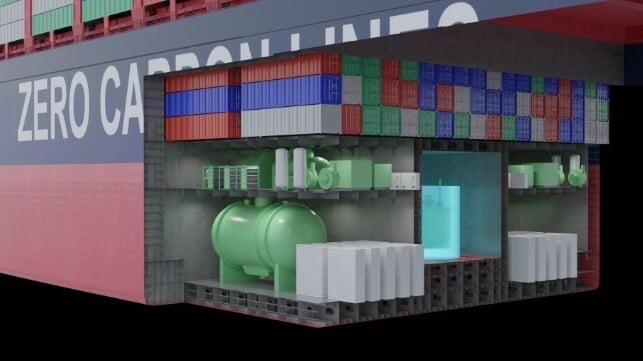

More designes, but still no firm orders:

Not to power trading ships but stationary floating nuclear power plant:

Samsung Heavy Industries have some experience in shipbuilding and KHNP is not new to Nuclear Power Plants, Seaborg may be the “new boy on the block” here, but they appear to have some powerful backing.
I don’t know enough about the subject to judge if there are any major difference between the proposed reactors from ThorCon and Seaborg, except that Seaborg use spent fuel from existing plants as part of the process.
In any case, none has yet built any floating nuclear power plant based on MSR technology.
(The Russian one that is in operation in the Arctic is based on “traditional” reactor technology)

A step further forward from a barge mounted Thorium fueled MSR for inshore use is Ulstein’s Thor and SIF concepts (Mentioned here before, I believe):
PS> Doesn’t say if this has anything to do with ThorCon, or Seaborg, though.

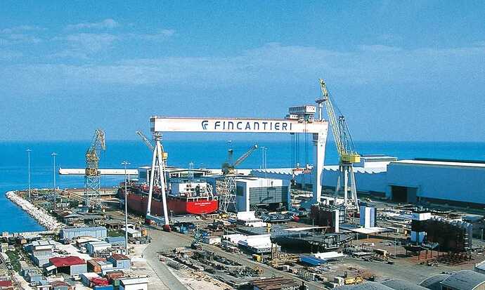

I hope Fincantieri does better with nuclear reactors than they have with US Navy ships.
