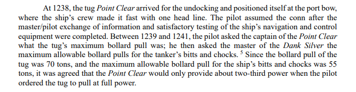

I thought this was interesting as we had just discussed strength of ship’s bitts and chocks
