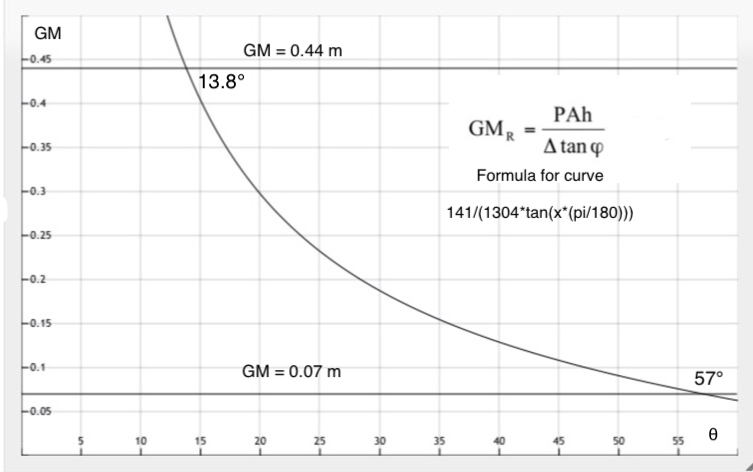

Next we calculate the GM with the USCG Weather Criterion formula: GM = PAH/ W * tan θ, where θ = 14°.
P = 0.055+(L/1309)^2 = 0.055 + (60/1309)^2 = 0.057101. PAH being Pressure x Area x Height - W is displacement and θ is the angle of heel (1/2 Deck edge immersion or 14 degrees). - The pressure being approx the equivalent of about 55 kts.
It is somewhat special that the angle with the point of deck immersion is cotan of freeboard divided by 1/2 B = 3.12/5.7 = 0.547368, then θ = 28.69°, the half value of that angle is a just a little bit over the other value of 14°.
From the picture I found:
A ≈ 450 m^2
H ≈ 5.49 m
PAH ≈ 141
GM = PAH/ W * tan θ = 141/1273 * tan θ ≈ 0.44 m.

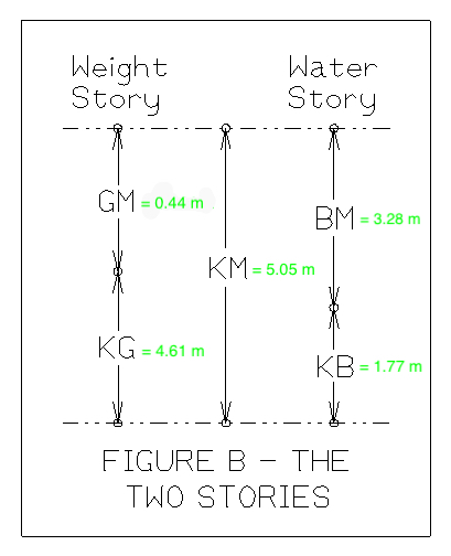

With help of the estimation methods more hydrostatics were calculated like this one for KB.
BM was calculated with this formula which I know from experience is pretty accurate.

The result of all the exercises is shown below.
Passengers on these ferries carry a lot of luggage, food bought on the market and other things. I calculated with an average weight of a passenger of 75 kg and 50 kg of luggage, which brings the total to 125 kg. The number of passengers and crew on the COI was 690 while the actual number on board was a staggering 2470. The overweight is then 2470 - 690 = 1780 * 0.125 ton = 222.5 ton.
Furthermore it seems that there was also unauthorized cargo brought on board, which is hardly surprising. A rough guess could be 10% of the CDW = 0.1 * 214 ton = 21.4 ton. Final total overweight is 222.5 + 21.4 ton = 243.9 ton. With a TPC of 4.17 ton/cm this amounts to 243.9/4.17 = 58.5 cm deeper into the water!
The KG is then calculated.
Δ = L * B * D * Cb * ρ = 60 * 11.4 * 3.05 * 0.61 * 1.025 = 1304 ton. Where ρ = density of seawater = 1.025 kg/m3
Δ = 1304 + 243.8 = 1547.9
KG for 1304 is 4.61 Moment about keel is 1344 * 4.62 = 6024.48
KG for 243.9 is 6.87 Moment about keel is 243.9 * 6.87 = 1675.59
Total KG is 7700.07
Final KG = 7700.7/1547.9 = 4.98 m.
GM = KM - KG = 5.05 - 4.98 m = 0.07 m
For calculating some GZ values we can use George Atwood’s formula which he published in 1798 in “A Disquisition on the Stability of Ships”. He described a formula with which the stability of a ship at larger heeling angles could be calculated. Before that time only the static stability for small heeling angles was known. At larger heeling angles it was uncharted territory and many ships sunk like HMS Captain due to a low freeboard and design errors. As a result 500 lives were lost.
Atwood’s formula: GZ = (GM + 0.5 * BM * tan θ^2)) * sin θ
For instance for an angle of 14° GZ = (0.44 + 0.5 * 3.28 * 0.249328) * 0.241922 = 0.19 For the overloaded situation GZ = 0.003 !!
Of course this is a purely theoretical exercise because we know far too little to make an exact calculation. The only intention is to show what more or less can happen if the rules of loading a ship and good seamanship are disrespected as was the case here. Obviously the so called captain had no clue about these things otherwise he would not have risked his own live and that of his passengers. No high tech is involved, only one look at the load line would have been sufficient. Come to think of it, the load line would not have been visible at all…

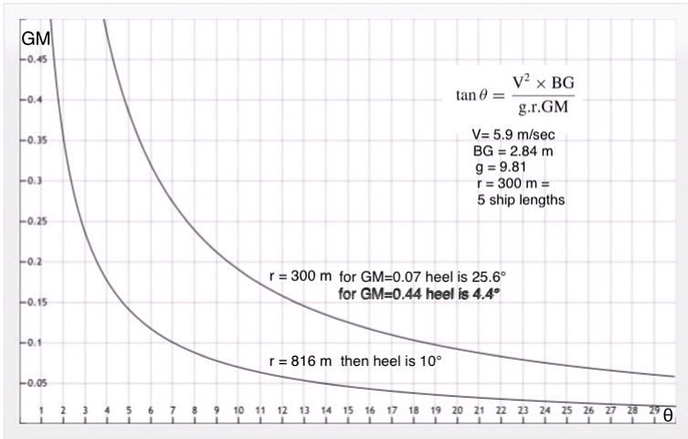

To conclude with a little afterthought which illustrates the consequences of the rudder on the ship’s heeling behavior, the USCG Weather Criterion and the rolling time period.
The turning circle manouevre starts from straight motion at the test speed, the rudder is turned to 35° or the maximum rudder angle permissible and kept at this angle, until the ship has performed a turning circle of at least 540°. The trial is performed for both starboard and port side. A five ship length radius is the usual distance for such tests. For starboard the ship will first heel a little to port before the centrifugal force kicks in heeling the ship to starboard and the other way around with a port order.
Under these conditions the ferry will heel 25,6°, which is what could be expected. I even expected a larger heel.

With the GM = 0.44 m of a normally loaded ship this value is in the range of 0.3 - 0.5 m which is good. The ship then heels 13.8° and that is within the legal limits. It is a different story if the GM = 0.07 m, the heeling angle is then a dramatic 57°.
The rolling time period for GM = 0.44 m is 13.7 sec and for GM = 0.07 m 34.5 sec from which there probably is no recovery possible. An acceptable rolling period is if 3/4 * B < T < 4/3 * B, which is here 8.6 < T < 15.2 seconds. With the GM = 0,44 m the rolling period is well within the limits.

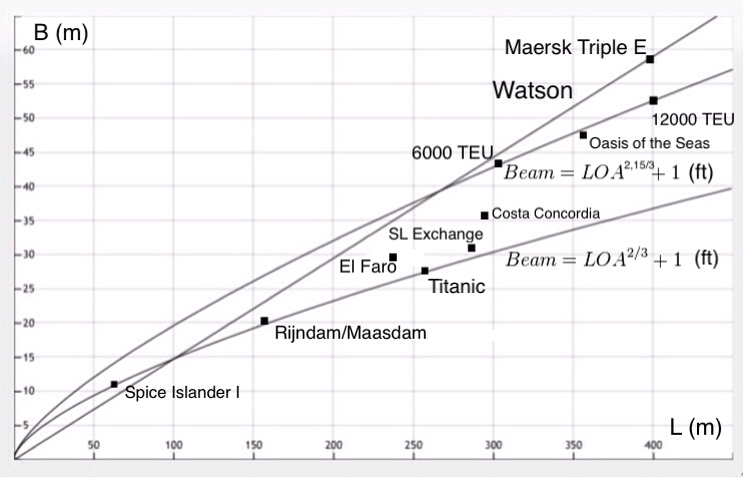

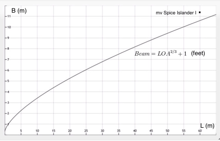

The formula in the graph was used by naval architects to calculate the beam from the LOA. For the Spice Islander I it is a little bit off, but this is a ferry with a forward ramp which probably requires a bit more beam. Calculated with the formula the beam should have been 10.62 m instead of 11.40 m.
When ships got longer and new type of ships were developed, like container ships and RoRo’s, the formula doesnot work anymore. I reworked it a little so that it now better fits the new generation of ships. This is illustrated by the graph below.
The straight line is Watson’s. It is too simple and there never will be a linear relationship between L and B. However, in the end it fits the Maersk Triple E class ships perfectly!
This is Watson’s graph from which I took the “most merchant ships” line.
