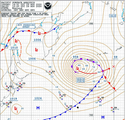

The update said weather at the time was reported as wind force 4 on the Beaufort Wind Scale, corresponding to 13-18 mph winds, with north-westerly seas of 5 to 6 meters and a “long high swell”.
And given this:
It is possible that the swell was a set from the 958 low pressure system? Swells that were not captured by either the forecast or the analysis?
There were other ships reporting nearby. Did they experience any like the One Apus?
I’m interested regarding the salvors are weighing each containers actual weight compared to what was reported/documented. At least they are looking at most angles. Most are rightly looking at speed and course, but proper loading/lashing by weights is crucial…That has been discussed on this site before. Regarding high swells from an area you are not in is entirely possible as well. Would be interested in what other vessels were reporting near them, but lack of info where they were at leaves more questions than answers.

33°15’N, 172°35’E — at November 30, 11:32 UTC
Marked by the little black dot.

The incident took place about 30 Nov 1200 hrs UTC but there’s no sea state analysis for that time. Only 12 hrs before or after. But the seas increased significantly in that time span,
12 hrs before - about 4 meters
12 hrs later:- EDIT, looks like I read the wrong position, more like the 6 meters the ship was reporting.
