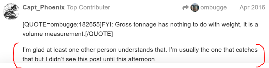

[QUOTE=ombugge;182655]FYI: Gross tonnage has nothing to do with weight, it is a volume measurement.[/QUOTE]
I’m glad at least one other person understands that. I’m usually the one that catches that but I didn’t see this post until this afternoon.
