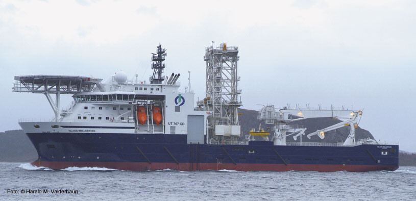

PS> It is also possible to launch free fall lifeboat over the sides:
Source: Island Wellserver (03/2008) | Maritimt Magasin
