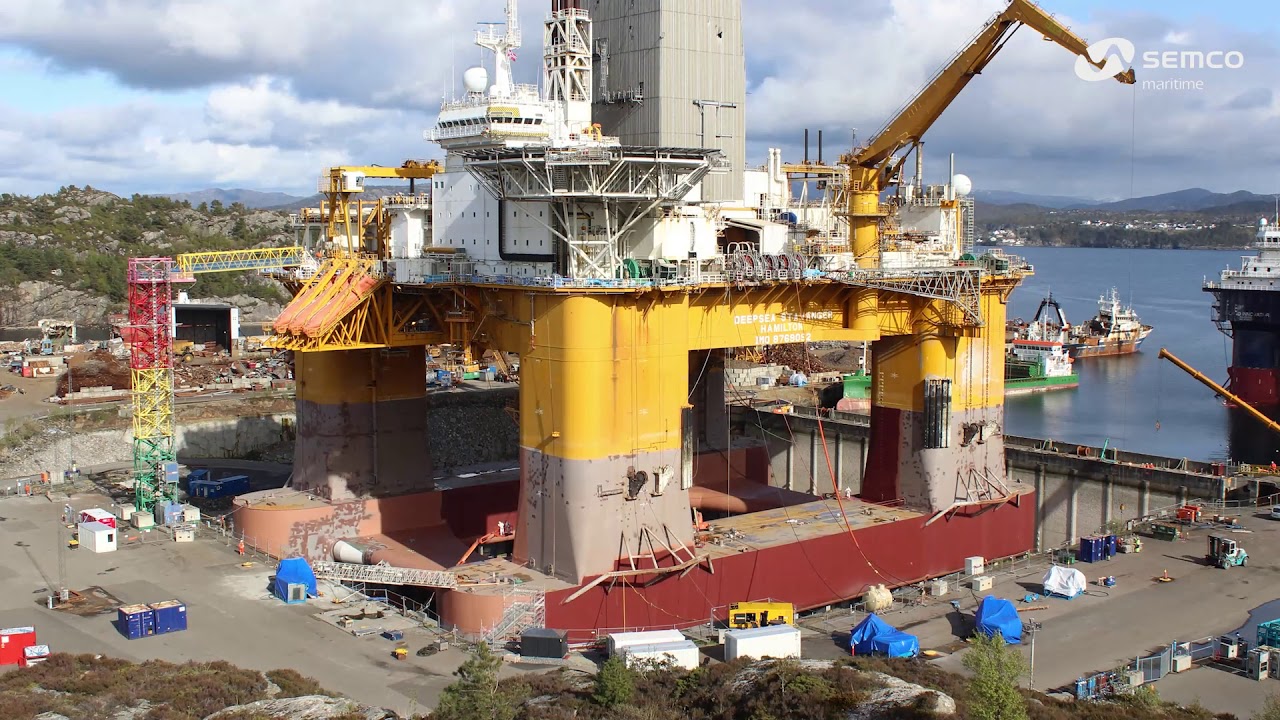

High docking of rigs
The semi-submersible rig, Deepsea Stavanger, completed a high docking (with thrusters on) in Semco Maritime’s rig yard at Hanøytangen, Bergen, in Q1 2020.
Semco Maritime’s rig yard at Hanøytangen:
