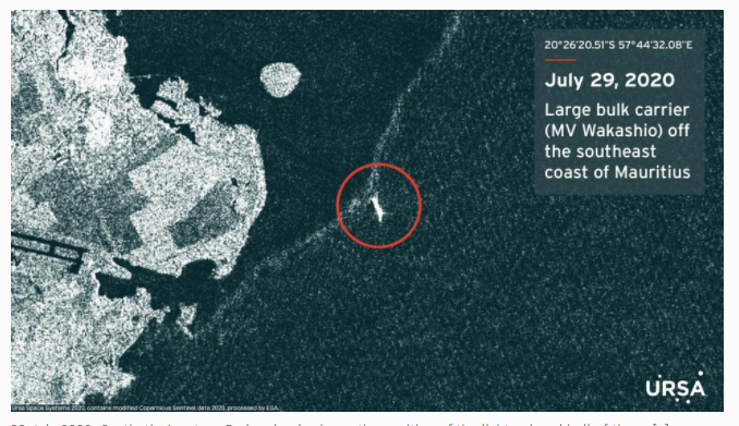

I don’t see how the ship could have grounded there without being both off-track and off-course.
Track_MV_Wakashio_9
Did the ship ground somewhere east of that outcrop around that charted rock just east of the wreck symbol?
Below the word “Deux”
Adding to the number of clues they were headed for trouble, the lights from the town of Mahébourg would have been difficult to ignore.
Seems like they would have had to pass over that 12.8 meter spot at the Southern Entrance.
Most incidents like this have more than one cause. That might be the case here. ECDIS track wrong, radar on the wrong scale and gain turned down too low or similar errors.

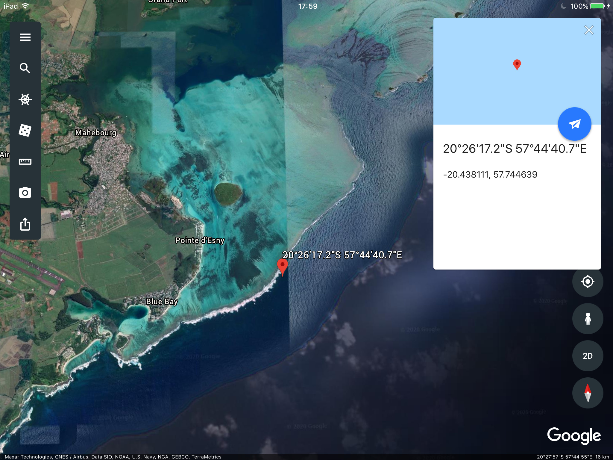

This is the last known AIS position on 5 August as shown on Google Earth.

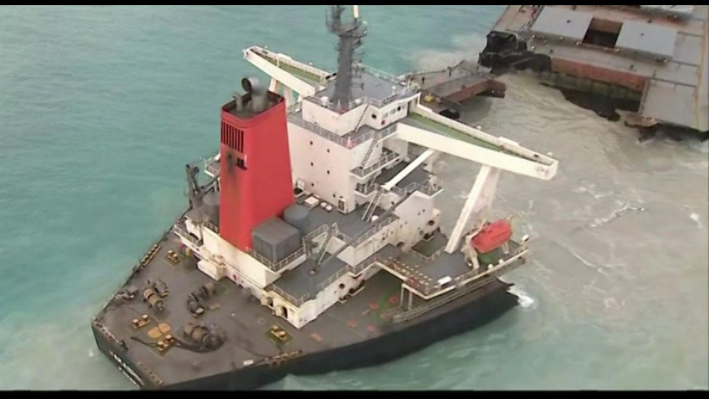

Looks like she has broken in two (As predicted):
The two tugs Boka Summit and Expedition appeaser to have lines on the Fwrd part, but not yet pull it off the reef.Maybe not full separated yet??
