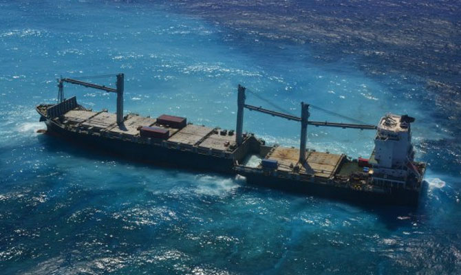

Autonomous salvage vessels? The reality is that autonomy will only exist in certain sheltered waters, unless autonomy becomes so integrated that the whole world fleet switches over at once. By then all ships will be Chinese anyway.
Even today manned ships with the latest equipment are foundering, despite or because of ECDIS.
http://www.tradewindsnews.com/casualties/1377352/nova-cura-investigation-reveals-failings-in-electronic-chart-data
