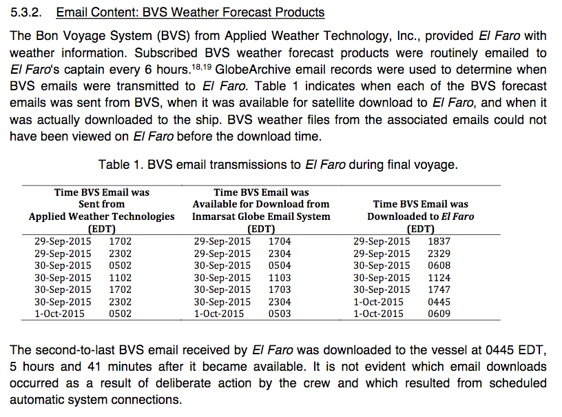

Has anyone got any comments on the following oddities re. weather data in the the reports:

  1. https://dms.ntsb.gov/public/58000-58499/58116/598654.pdf Extract from Electronic Data Report
    Is it really possible that no one on board downloaded the 23:00 hr BVS data until 04:45 (a delay of nearly six hours), at a time when they knew that they were closing with a hurricane (it happens that it was downloaded just before the Captain returned to the bridge on the morning of the 1st)?
  • The single WX obs that was sent was mentioned at the hearing. It was mentioned that the postion falls inland on the Island of Cuba, I just checked and that’s correct.
  • the download at 0445, that makes sense if the captain did not check the weather after 2300 hrs and then checked at 0445 hrs.
At the risk of making a mountiain out of a molehill this seems like a telling point to me. The wx update files come in by email. I relieved a captain one time. The ship had a similar set-up. Email was rcvd in the captain’s office but the wx program was instaled in the capt’s office and on the bridge. That captain told me that he didn’t forward the wx data to the bridge until he “reviewed them”. He repeated that several times, making a point. I took that as a desire to control information. Instead I set up MS Outlook (using a “rule”) so it forwarded the email containing the data to the bridge when received. More eyes the better.
