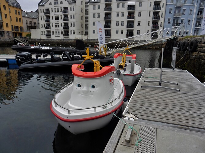

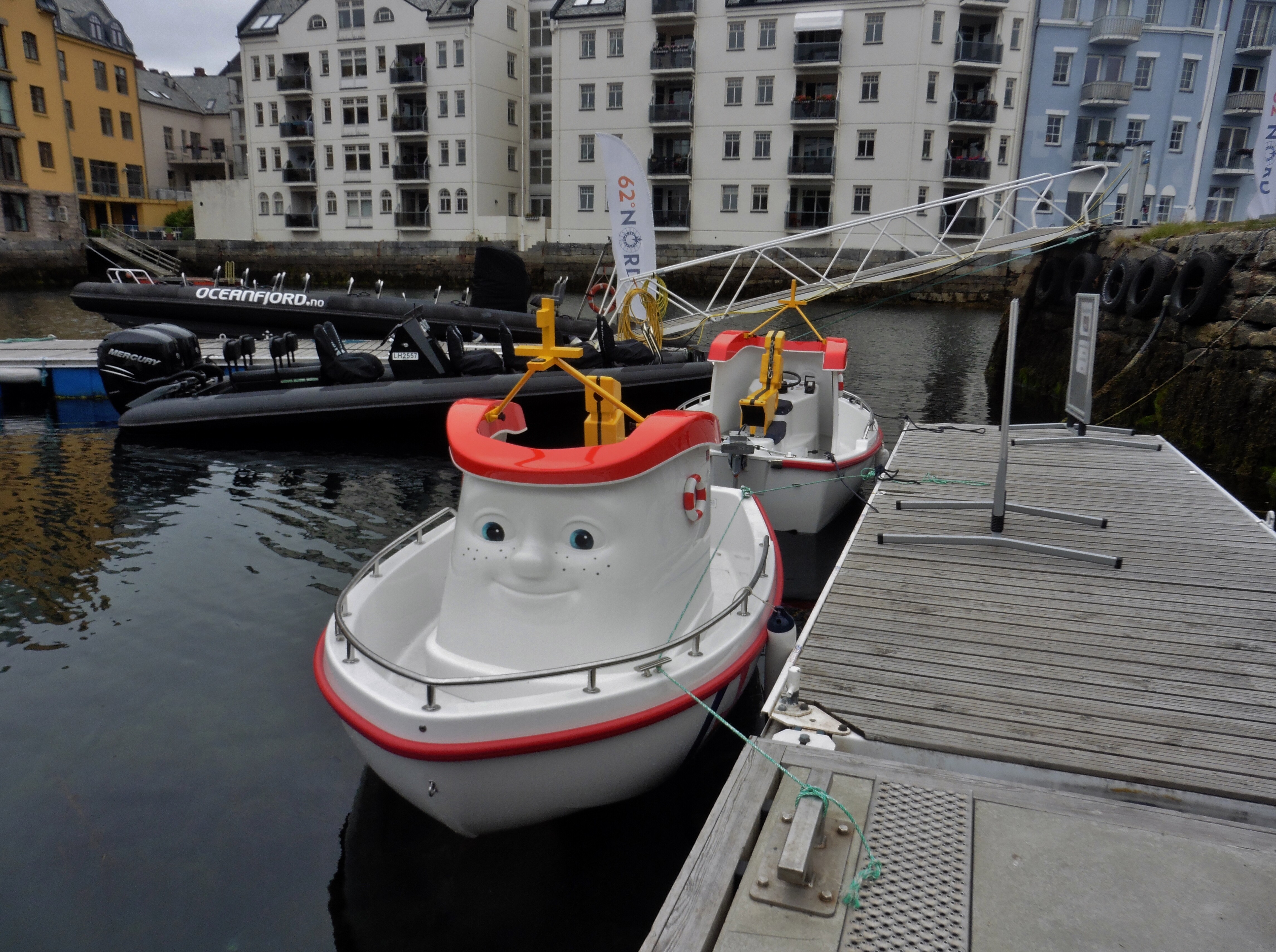

Several Elias the Tugs exist in real life. Used to promote Redningsselskapet (NSSR) at festivals around Norway.
Here is two of them seen at the Boat Festival in Ålesund in 2018:

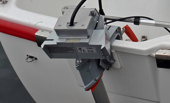

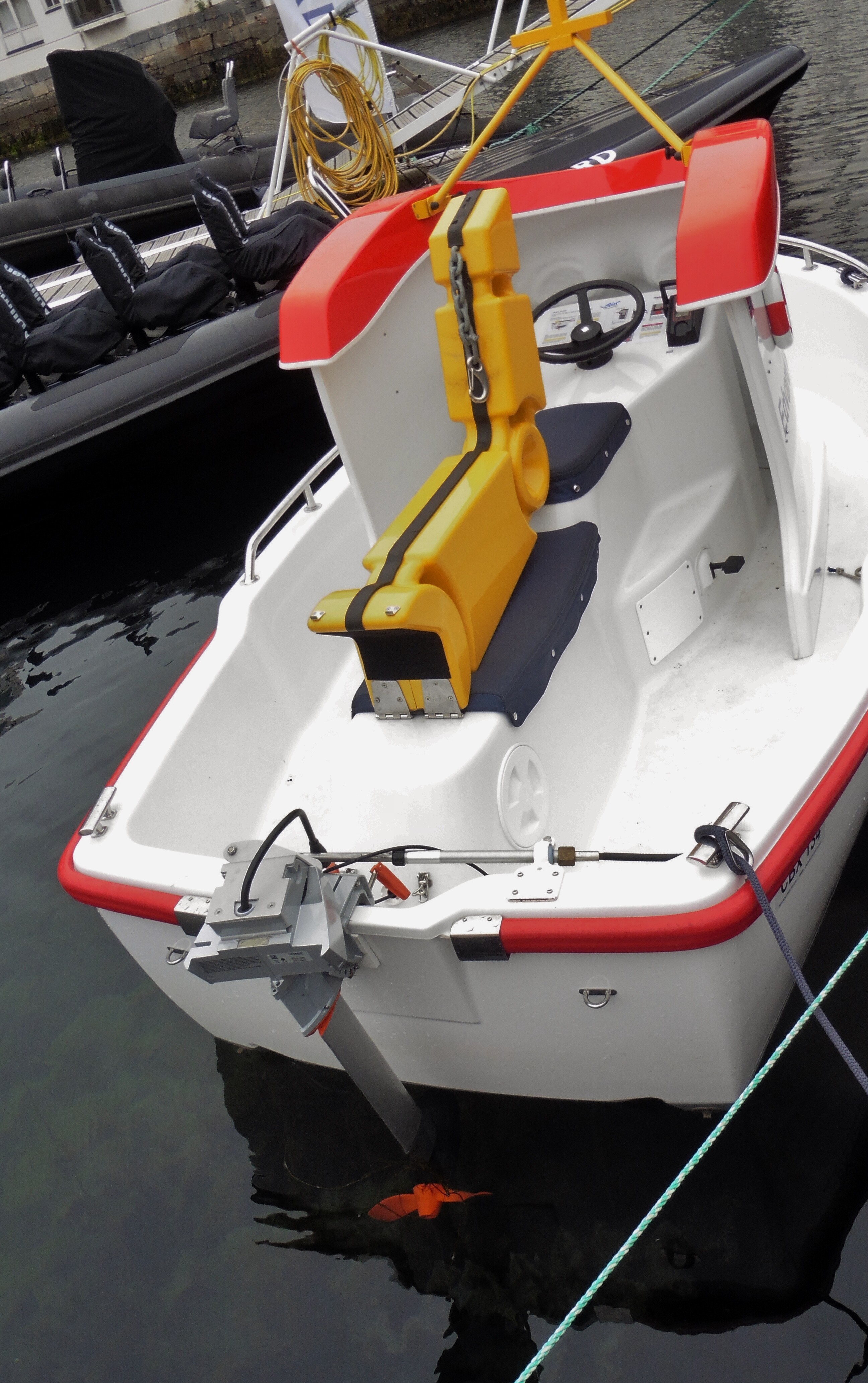

Fitted with Electric outboard motors of course:
