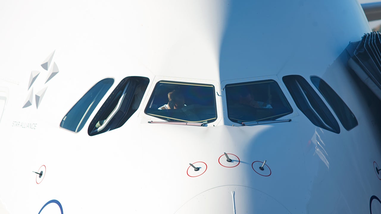

The final report on the crash of Air France flight 447 has been released:
It is worth study as an example of state of the art accident investigation.
Earl
Thanks for posting
Haven’t read the final yet, but, reading the preliminary you first posted, it’s apparent that state of the art equipment cannot completely replace humans in these situations. I am amazed that three experienced flight officers on a flight deck could not in 5 minutes determine looking at flight instruments, attitude indicator, radar altimeter etc. and determine that they were in a stall situation. All things considered, if the air speed dropped to zero(caused by pitot tube icing/failure) the immediate, automatic pilot action would be “stick to the dash, pedal to the metal” to regain airspeed ASAP with one officer calling out altitude while the senior in command took over controls manually.
I was a ground tech on the first aircraft making completely hands off landings in aircraft carriers on the east coast. These were completely hands off landings using 3 channel autopilots providing pitch, yaw and power augmentation coupled to the ship’s ILS system, providing hands off control from the 16 mile window Down to the #3 cable on the flight deck. (see reference below)
On June 24, 1969 the first operational “hands off” arrested landing using the AN/SPN-42, Automatic Carrier Landing System (ACLS), on a aircraft carrier was performed by Lt. Dean Smith and Lt. (j.g.) James Sherlock from VF-103, when their F-4 Phantom landed aboard the Saratoga.
What happened on Flight 447 is quite disturbing and inexcusable on the part of the flight crew and design of the aircraft. No angle of attack indicator, really???

[QUOTE=Infomania;73595]Thanks for posting
[/QUOTE]
I think that there’s a lesson here: when an experienced crew does something inexplicable, you don’t just throw up your hands and say “I dunno, they just screwed up,” you look for the deeper causes.
[/QUOTE]
It’s part of the half-joking description of the Airbus FCS as a system designed to protect the aircraft from the pilot. It’s pretty clear that the manual mode wasn’t really taken seriously by anybody, crews included. Which makes our subthread on-topic for drilling: you drillers and tool pushers are looking at your future as inevitable and irresistible economic pressures cause automation to take over. The crash of flight 447 occurred with the aid of systems that are developed in one of the most controlled fashion in the world. You look at NOV’s stonewalling of the inquiry and you have to ask, “What is it they didn’t want people to see?”
Earl

How Lousy Cockpit Design Crashed An Airbus, Killing 228 People | Co.Design: business + innovation + design
NEW EVIDENCE SHOWS THAT A LACK OF PILOT FEEDBACK FROM THE COCKPIT CONTROLS LED TO THE CRASH OF AIR FRANCE FLIGHT 447. WHAT LED TO SUCH A DESIGN DISASTER?
On June 1, 2009, Air France Flight 447 crashed into the ocean on its way back from Rio de Janeiro. 216 passengers and 12 crew died on impact. This month, the official investigation is likely to conclude with “human error” as the culprit–pilots making mistakes that forced the plane to crash. But evidence unearthed by The Telegraph tells a different story, that the pilots of the Airbus A330-200, and everyone else on the plane, were really victims of bad design.
DOMINATED BY COMPUTERS, AIRBUS DESIGNS ITS PLANES WITH LESS TACTILE RESPONSE.
And it’s not just one single component that could have avoided the tragedy. Multiple Airbus-designed systems played a role to create a deadly feedback loop that convinced them to climb to the point that the plane stalled and it fell from the sky. By the time the pilots figured out what was going on, they’d lost too much altitude to point the nose down and gain the speed necessary to maintain lift. Even if you have a very basic grasp of how planes fly, I think the cockpit’s last words from the blackbox transcript explain the problem with eerie conciseness:
02:13:40 (Robert) “Climb… climb… climb… climb…
”02:13:40 (Bonin) “But I’ve had the stick back the whole time!
”02:13:42 (Dubois) “No, no, no… Don’t climb… no, no.”
02:13:43 (Robert) “Descend… Give me the controls… Give me the controls!”
(article continues)
It just proves what everbody knows in the industry that modern pilots are not taught to fly anymore

It’s actually worse than that. The article doesn’t mention that the “side stick” controllers are mounted on the outside of each seat. This means that not only does the pilot not flying have no tactile feedback from what the pilot flying is doing, the actions of the pilot flying are not easily visible either.
The lesson from all of this to the designers of “drill by wire” systems (who I assume are beavering away as I write this) is that your system should augment and not replace human judgement and all forms of feedback, visual, tactile, and auditory, should be used in safety-critical or safety-relevant environments.
