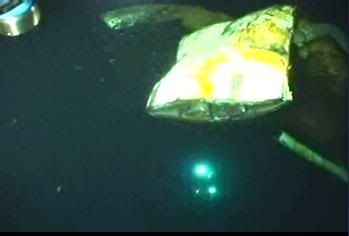

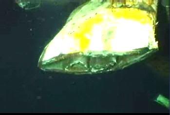

[QUOTE=company man 1;35169]Bigmoose, Alvis, or anyone who can post a picture of the riser after the cut would be much appreciated. Thanks, CM1[/QUOTE]
Stub of riser on LMRP:
Source: http://www.doomers.us/forum2/index.php/topic,68178.msg1069604.html#msg1069604
LMRP end of intermediate riser section after cutting:
Source: http://www.doomers.us/forum2/index.php/topic,68178.msg1069029.html#msg1069029
CM, are you talking about a view of inside the flexjoint, or of the riser after it was sheared? Post 2002 has an attachment that has one of the riser with the dual pipes in it. I am really trying to get my head around what/how there are two pipes inside the riser. One certainly is the DP, and the other is so similar I have to wonder if they didn’t shear the DP, then cycle the shear rams, and when they opened it up, slingshot the sheared DP up into the riser alongside the upper section. Some have suggested it is the lower production liner, but I cannot fathom several thou feet of casing going up that high in the riser. thoughts?

[QUOTE=alvis;35080]Could someone comment on PLCGuy’s images of the inside of the riser? My untrained eye see drill pipe. But what’s that to the right?[/QUOTE]
It looks like its drill pipe inside the riser Alvis. Thanks for posting the pics PLC guy.

I was snapping screenshots like crazy this morning during the shearing and riser removal operation. Just now had a chance to get back to sorting through them and found one more that might be of interest. I haven’t seen this view posted anywhere else so here it is: the other (top - away from flex joint) end of the kinked riser section. At this end I see only one pipe. Hmmm?
[ATTACH=CONFIG]933[/ATTACH]
[QUOTE=OldHondoHand;35172]CM, are you talking about a view of inside the flexjoint, or of the riser after it was sheared? Post 2002 has an attachment that has one of the riser with the dual pipes in it. I am really trying to get my head around what/how there are two pipes inside the riser. One certainly is the DP, and the other is so similar I have to wonder if they didn’t shear the DP, then cycle the shear rams, and when they opened it up, slingshot the sheared DP up into the riser alongside the upper section. Some have suggested it is the lower production liner, but I cannot fathom several thou feet of casing going up that high in the riser. thoughts?[/QUOTE]
This is the way I interpret the pictures. The pipe has been smashed by the shears obviously while it was being cut. The force required to make this cut evidently caused the pipe to split in the seem where it is rolled into a tube when manufactured. When the burst rating of pipe is made it is based on one of two factors. As pipe is pressured up to the maximum pressure it will rupture in one of two areas. it will either rupture where the tool joint is joined to the tube, or the seem where it is rolled while being manufactured. The manufacturers of drill pipe will take a sample joint of pipe per so many joints in a lot. This pipe will purposely be pressued up until it ruptures. the average rupture pressure is the max bust pressure. This has been done on all makes & models of work string taking into account the type & grade of the steel. This is also done with tubing, casing, Etc. That is why it is SOP to never pressureup to more than 80% of burst pressure. The pipe is going to be approximately 1/3 the size of the riser. This is one third the size of the riser. I am glad you guys were on the ball on this thing. I was silent becdause I didn’t want to make any statements until I hopefully had a chance to see if the casing was lodged in the riser. If the casing had been lodged in the riser, it would have definitely had to remove all doubt from any BP apologist’s mind that BP had ordered casing that could not do its designed job.
Edit: A friend of mine designed those shears. His company has the exclusive patent on them. When I finish the job I am on I will call him & see if he can send me some pictures to post of some of the cuts they have made. His company has shears that are capable of cutting up to 60" drive pipe.

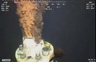

tic toc…so…the cap has been in place for a good while now…
In live feeds, we are currently seeing, on a few cams, a good flow emerging from underneath the bottom of the cap AND, on one cam, a high velocity flow emerging from one of the relief ports on top of the cap…
based on flow prior to the cap being placed, it wouldn’t appear they’re suctioning off any oil to the surface…
BP only said that from THIS point, the relief ports would be slowly closed…but NO time frame…
any thoughts…?
and…IF hydrates had formed and were blocking the flow, wouldn’t it be likely that they also would have blocked that top port that we can see the high velocity coming from…?
and…IF hydrates had formed, would we see them remove the cap pretty quickly OR would it be possible to remedy that situation with the cap in place…?
I agree with your thoughts on the 7" casing going up like that. One problem it would have is going through the crossover. I do believe that it is possible that the 9 5/8" or the crossover could have ruptured while they were attempting to break circulation before pumping the cement job & could have possibly led to the cement being displaced completely away from the formation where it was supposed to cover, but even at that, I have trouble believing casing could have been displaced into the BOPs. It is possible though & hopefully one day, the truth will be unveiled.
