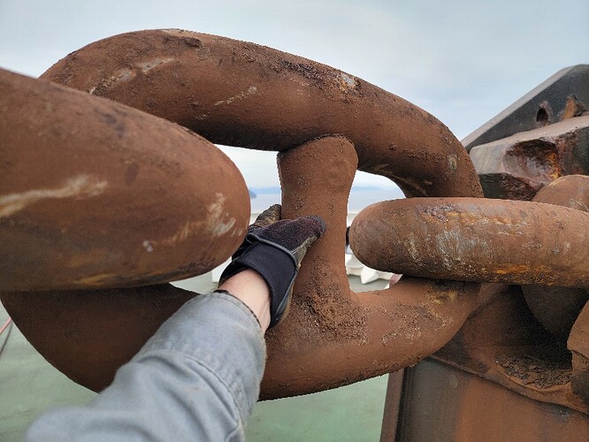

Up first is an anchor chain link, with a hand for scale. When the anchor is up, there’s about eight hundred feet of this chain piled up in the chain locker.

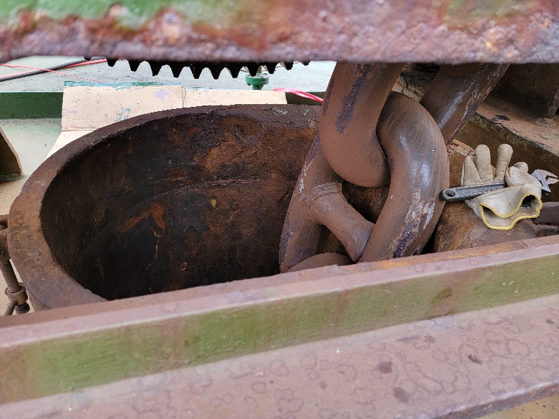

Here you can see the top of the spill pipe with the chain leading down into it. Glove and wrench for scale.

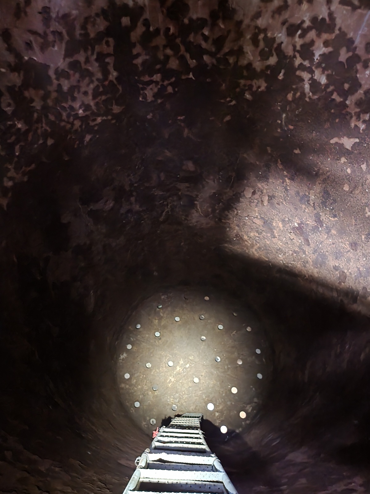

And this is the chain locker (or manger, or chain bin, or whatever you want to call it) with all the chain pulled out and freshly cleaned. The ladder is temporary. You can see there’s still a lot of rust on the steel even after cleaning, which consumes oxygen in this enclosed space. Imagine it if it hasn’t been cleaned in years with eight hundred feet of rusty chain piled up in it.
I imagine that he’s not the only man to try it, but you should consider him a lucky one - confined spaces like this kill people all the time just from bad air, even without the extreme danger posed by that massive chain flying out around him if they dropped that anchor before he could get out again.
